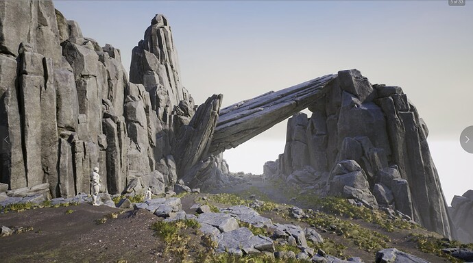

UPDATE 3: The terrain generators all seem to use top-down projection. So steep walls are distorted ugly messes … and forget about any overhangs.
I thought Gaea would work, but it stinks for any close-ups. The shortcoming of many terrain apps is that they’re designed for backgrounds or aerial views. If you want to walk around (or design a house that touches the ground) they just won’t work.
This image is a part of promising direction. The scene was made in Blender (as well as UnReal) so all of the geometry is three-dimensional, and not top-down projected. The next challenge is converting the node-based materials from Blender to V-Ray. Still looking into it with the file’s author.
The guys’s work is stunning. See the animated video
