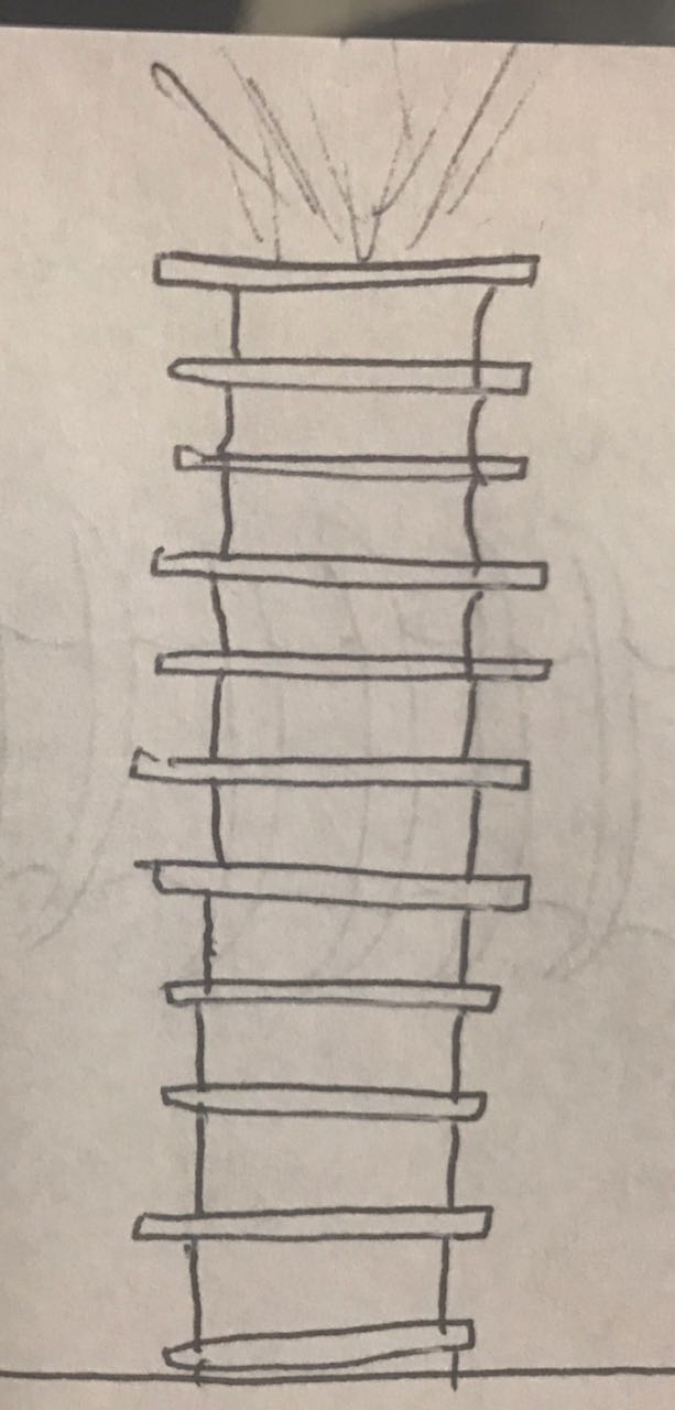

Hi, Im new at Rhino and I need some help doing these draws below. If someone have an idea or know how to make one of them, just text me here. I will give creedits and Im going to be very gratefull.
23846264_1810046582341515_1748746737_n
It seems all you need is a revolve command.
Make a profile, half of it, and revolve it around an axis.
So using your drawing blue would be profile and green is axis.
Just made it for fun…
Tower_reV1.gh (14.1 KB)
More fun: added a slightly different shape (on the left) and also some windows.

For 3D printing as an LED tablelamp I made some additions: there’s a base at the bottom to hold the LED puck light and a dome at top to reflect/diffuse the light. The holes should make for some interesting light patterns on nearby objects.
This design generates slowly because of all the SDiff operations, and it will take more than a day to print. Assuming it prints OK I’ll post the STL file on Thingiverse. Thanks again to HS_Kim for showing how to do this one.
