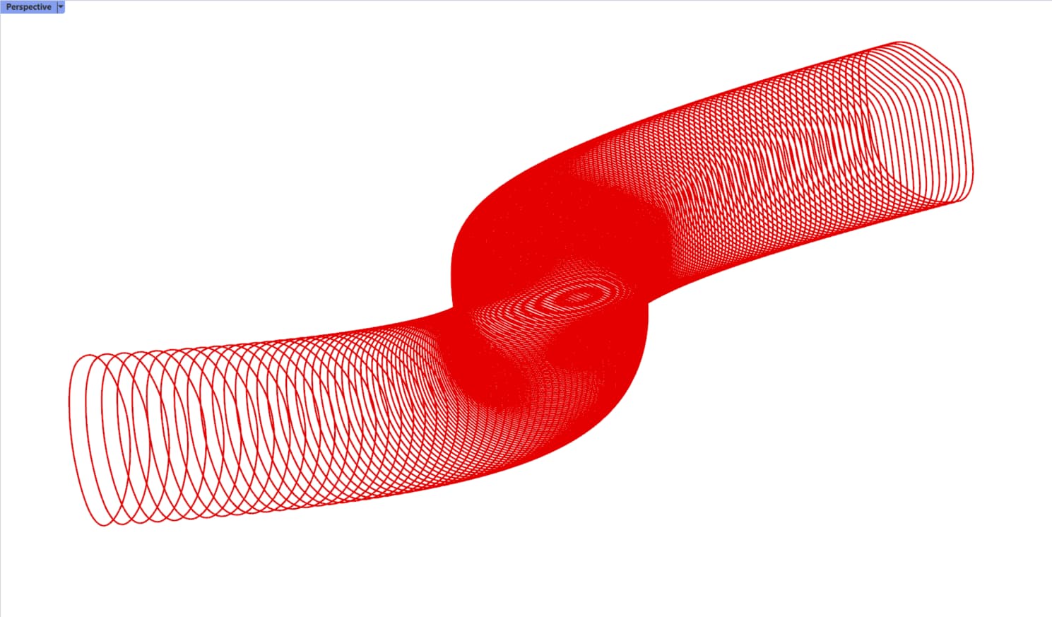

Yes, this does work for most cases, but i kept getting some errors in my workflow. I traced it to this example here. When lofting this circular profile, the edges overlap and will not join.
sweep_profiles.gh (25.5 KB)
Anyway i think it turns out Sweep1 is what i was really after!

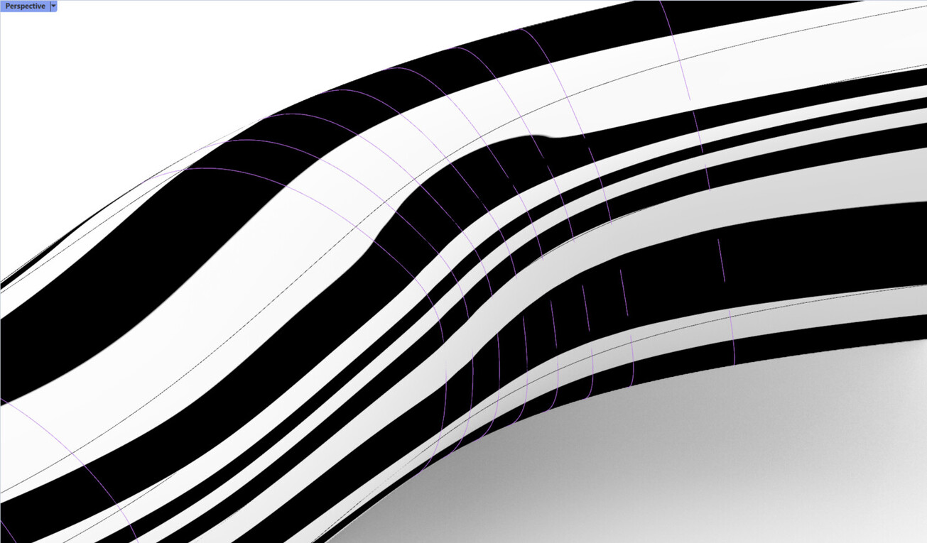

I’ve made yet another discover here.
in this case sweep produces some strange wavy artifacts in the surface
network surface produces a much smoother result which i am very pleased with.
sweep vs networksrf.3dm (1.5 MB)
The Rhino file contains a set of profiles which i am using to create the surface (purple),
and another verification set which the surface should pass through closely (red)
If anyone else comes across this consider using NetworkSrf. It produces the kind of surface I mistakenly expected from Loft
