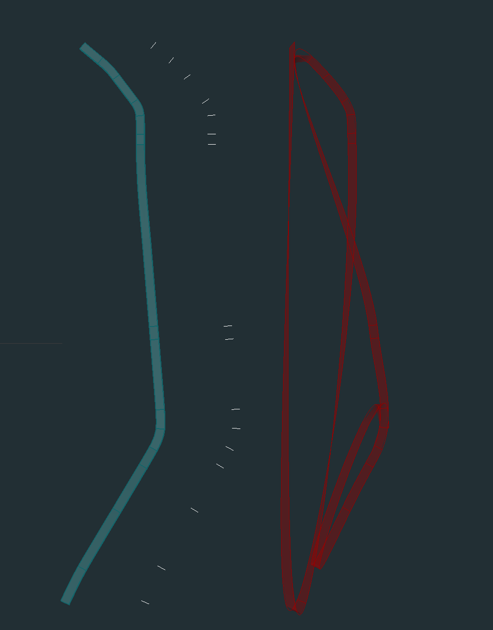

I want to loft all the white curves in queue in order to achieve the result in the left (blue)
But when i set multiple curves on grasshopper curve tab they are lofted with a randoma way (red).
How can i define the sequent of curve are lofted?
Thank you in advance!
The curves are lofted in the order they were selected or created in Rhino, you could sort them by distance from a starting point:
You are right…thank you very much !!
