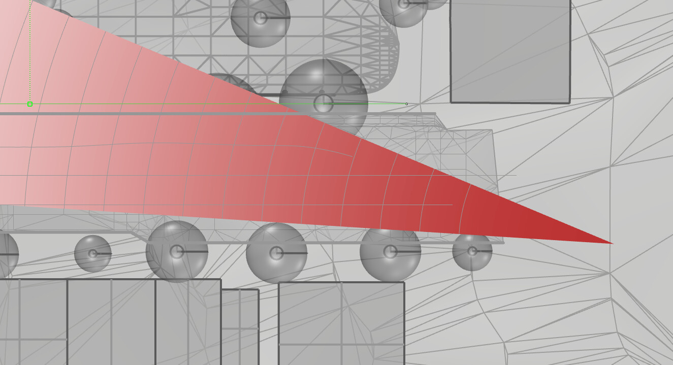

Even with the use object display attribtues selected, I still get the following
When rotating the semi-transparent hatch over the other stuff underneath, the other stuff disappears
-Jeremy
