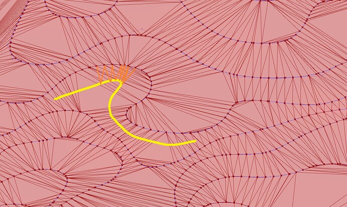

Hi Holo, thanks for your answers.
I’ve attached a typical problem: you can see where the flat faces are creating ‘steps’ (blue circles)
I was thinking if somehow I could put tweened curves (yellow) between the original curves, that it would lessen the issue (orange):
However, tweened curves seem to be very inaccurate
Delaunay mesh test.3dm (3.6 MB)
Delaunay mesh test.gh (9.5 KB)
-Jeremy

Hello
not sure it is OK, you can use Triremesh
Cull duplicates is mandatory in order to have a valid mesh.
Mesh could then be smoothed with keeping points on curves/But it keeps the discontinuities on curves.
Before
After

No problem, here it is
It uses my Nautilus plugin (just free components)
There are 2 components used
Smooth Weights (Z values) and Laplacian Smoothing
Welding the mesh is mandatory as Triremesh unweld on curve.
Delaunay mesh test.gh (42.5 KB)
The only thing missing is the smoothing along the curve but keeping points on curve. I don’t know if tools like that exists for mesh.

Hi Laurent,
I’ve just plugged in your script into my file, and it works really well :slight_smile:
Just wondering, if the mesh was already created using basic Delaunay, and had the problematic flat spots mentioned earlier, can the flat spots be removed in a similar way directly from the mesh without the contour curves?
Best,
Jeremy
Hello
I am not a specialist for that but it seems you are seeking some G1 continuity of the mesh.
I try here to interpolate heights using curves, but “Nurbs Curve” or “Interpolate” have they drawbacks.
Not sure there is a magic tool!
At the end mesh is a bit better but you can see band along some Axis, due to the use of Nurbs Curve.
I plugged polyline in gh file. But you can try whatever you want.
Delaunay mesh test V2.gh (47.6 KB)
