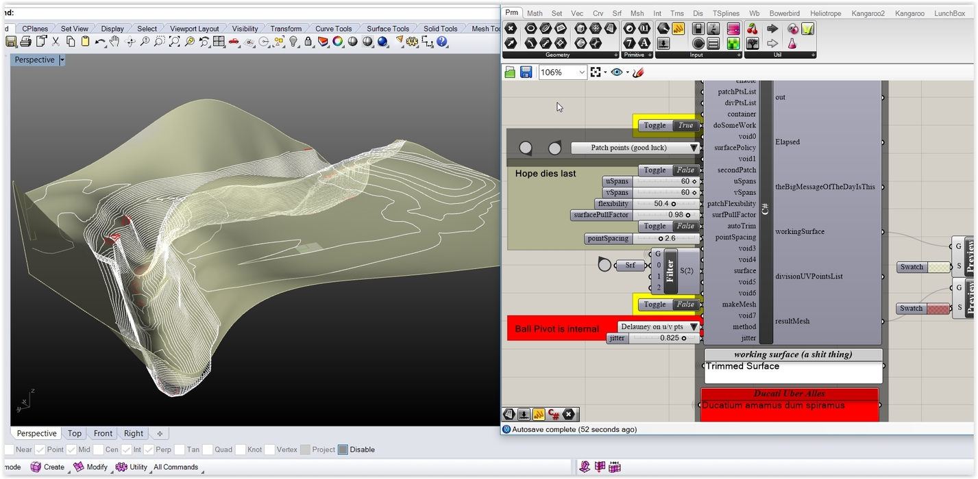

I cannot figure this out for the life of me. I feel like I’ve tried everything. When I’m creating topographies using the Delaunay mesh in, if there are very steep aspects to the terrain, the triangulation goes all wonky at the bottom and top. I’ve tried increasing points, decreasing points, doing the whole mesh in pieces, lofting then meshing…the list goes on.
Can anyone tell me what exactly is causing this or why it happens so I can figure out a way around it?

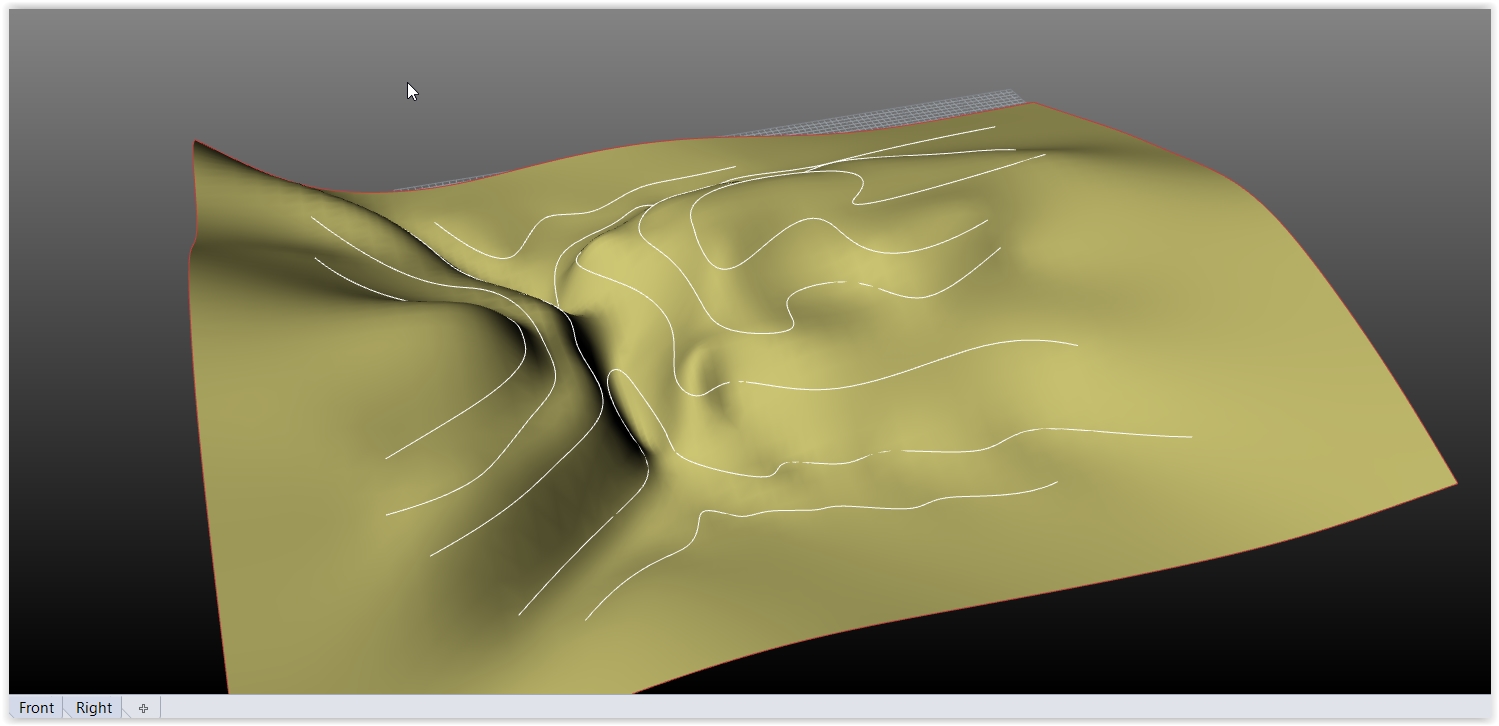

Delaunay is indeed a purely 2D algorithm, so distances between points are measured while ignoring the elevation differences. This makes delaunay behave badly for points whose local plane approximation does not align well with the global plane.
However you can always try remapping your points to get a better distribution. In this case, you could try creating a coarse nurbs patch through the landscape. It doesn’t have to be very accurate, as long as it provides a better approximation of the local plane throughout the point set. You then project all the (x,y,z) points into surfaces (u,v) space, and run your Delaunay algorithm on the (u,v) coordinates instead.
You will have to ultimately replace the mesh vertices with the original (x,y,z) coordinates to get a 3D mesh again.
Indeed that’s a good approach (but requires a certain cleaning on the Del mesh [depending on the case] . Maybe - just maybe- a ball pivot on u,v pts could be more appropriate [depending on the case]).
On the other hand … working on an approx mesh (Mesh Machine) and then adding more faces and/or adjusting the existed ones … maybe - just maybe.
Foreplay it was…well almost. Using David’s approach I got it close enough that I can ignore some of the issues for now. I’ll keep picking at it later and probably use the ball pivot method to help clean it up.

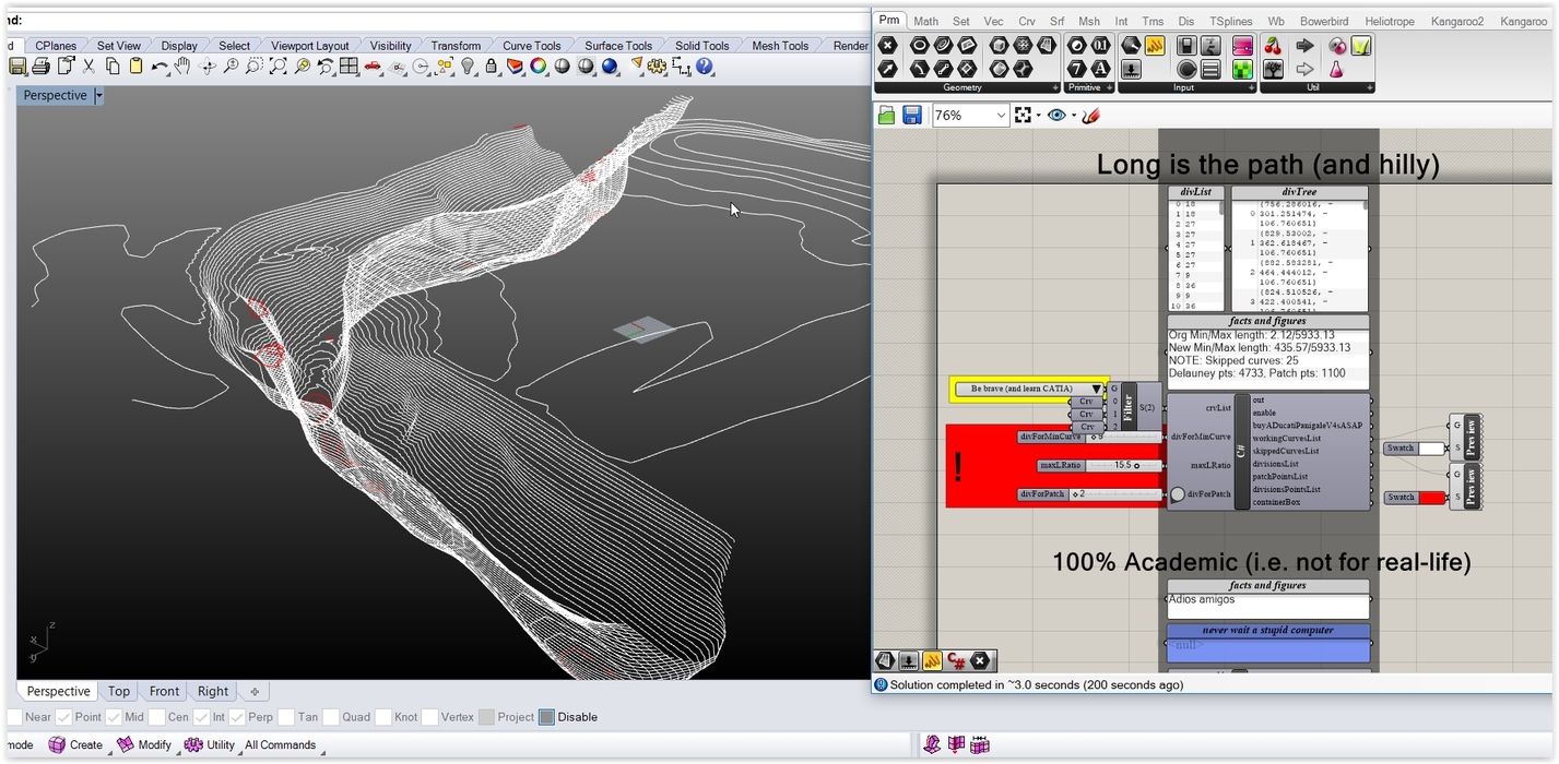

This (still WIP) is taking your suggestion some steps further … but for a variety of occasions is not the ideal way to cut the mustard.
Mesh_FromContours_V2.gh (140.2 KB)
Mesh_FromContours_V2.3dm (2.5 MB)
Spreads points proportionally to the crvs length (meaning that you need a safety net if small and long coexist [reds are the skipped ones]).
Then it does the quide surface either using a user provided one or one via patch VS pts (in 1 or 2 phases). But patch is very slow (for good reason):
Or a bit off topic:
Then you need to clean the Del mesh:
But even if you do that the result is… still … 1M miles away from some “ïdeal” solution:
Plan B (WIP): “enchance” the contours where is needed (say: do some special kind of mean mini curves), spread proportionally to the length points and use a ball pivot thingy.
