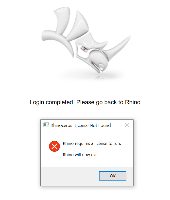

"License not found, rhino will now exit" when logging into my account
Hi! I am having an issue where, when I start up rhino for the first time on my windows, Rhino redirects me to login to my account and asks me to grant permission, when clicking “allow” an new window pops up saying to go back to rhino. At this moment I get a new rhino pop up saying “license not found, rhino will now exit” even though I have a license live and this was found earlier in the authentication process. Any ideas as to why this is not working? I am using my account both on my mac and windows (not at the same time), on the mac it works.

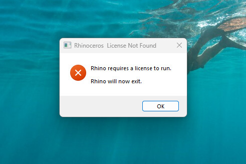

Hi John
I am having the same issue. I have tried everything above. Nothing seems to work. Any help with this?
Hi Wizard -
Since the above didn’t help, please contact tech support directly. You can find the mail address / phone number / chat button for your region on Rhino - Rhino Support
