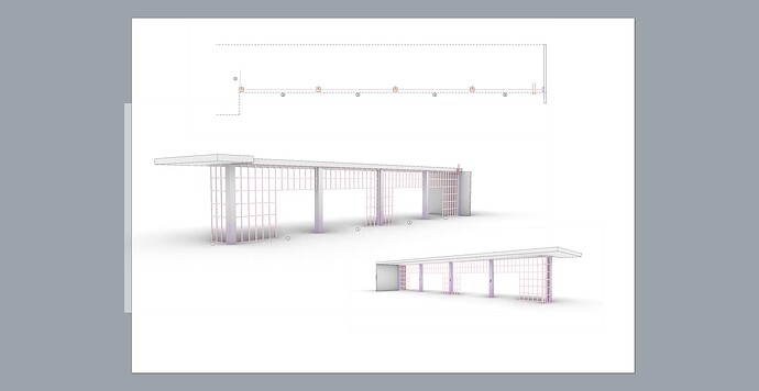

Layout windows does not apply Arctic display mode (or custom)
I have many issues in layouts, on Perspective or orthographic views, every display modes are ok, even the customs, but when creating a viewport onto a layout and applying the same view/display, it look like “ghosted”, flat and not using the sections plane, even after checking if they are well applied…
Help needed, latest drivers , test with or without CPU/GPU… reset by default… nothing works…
I also try both Mac and PC…
Join screenshot, on top Right view, bottom, the Right view inside a layout…
Arctic mode…
Regards

Hello - Does this happen with a new model, with just a box or something in it? If this is specific to one model, please SaveSmall, Zip and send to tech@mcneel.com with a link back to this topic in your comments.
Hi @pascal , @wim
I send you file , but after many tests, it happens that it is something linked to my layouts.
Creating a new layout with a new window, and it works… the matter is that actually i “clean” my file (to send), but my work file contains lot of layouts…
Antoine
By testing I finally found the problem.
I create my layout and my viewport inside a “template file”
Then in my work file, I import the layout from this template, but it also import this detail view.
Using the imported detailview makes the arctic or every other mode not working properly (like Xray without sections).
But if I create a new layout, a new detail inside, it works well.
I also copy paste the good detail view inside the “bad layout” aside the “bad” detail view.
Both are together, but one is ok, the other is not ok.
I think that the problem come from importing detail view from external file.
I test this step both on Mac an PC with the same issue.
Hope it helps to solve this
Hello - thanks for the details, I’ll see if I can reproduce this.
I cannot - can you please disable Enscape in Options > Plug-ins page and then close and restart Rhino? Is there any change in the behavior?
Hi -
Thanks, I can see what you are reporting with the file that you linked to in your eMail.
I’m not sure what’s wrong with that detail but I put it on the list as RH-64973 to be further investigated.
From an older bug item (RH-32010) I see that importing a layout that has a detail with an active clipping plane will somehow attach that clipping plane information in a file that has no clipping plane. As a result of this, I imagine, the clipping plane intersections are not getting display correctly. So that accounts for that part of your report. It’s possible that this duplication of clipping planes then also leads to the other things that you see but we’ll see what the developer finds out.
For the time being, I wouldn’t import layouts from files with an active clipping plane.
