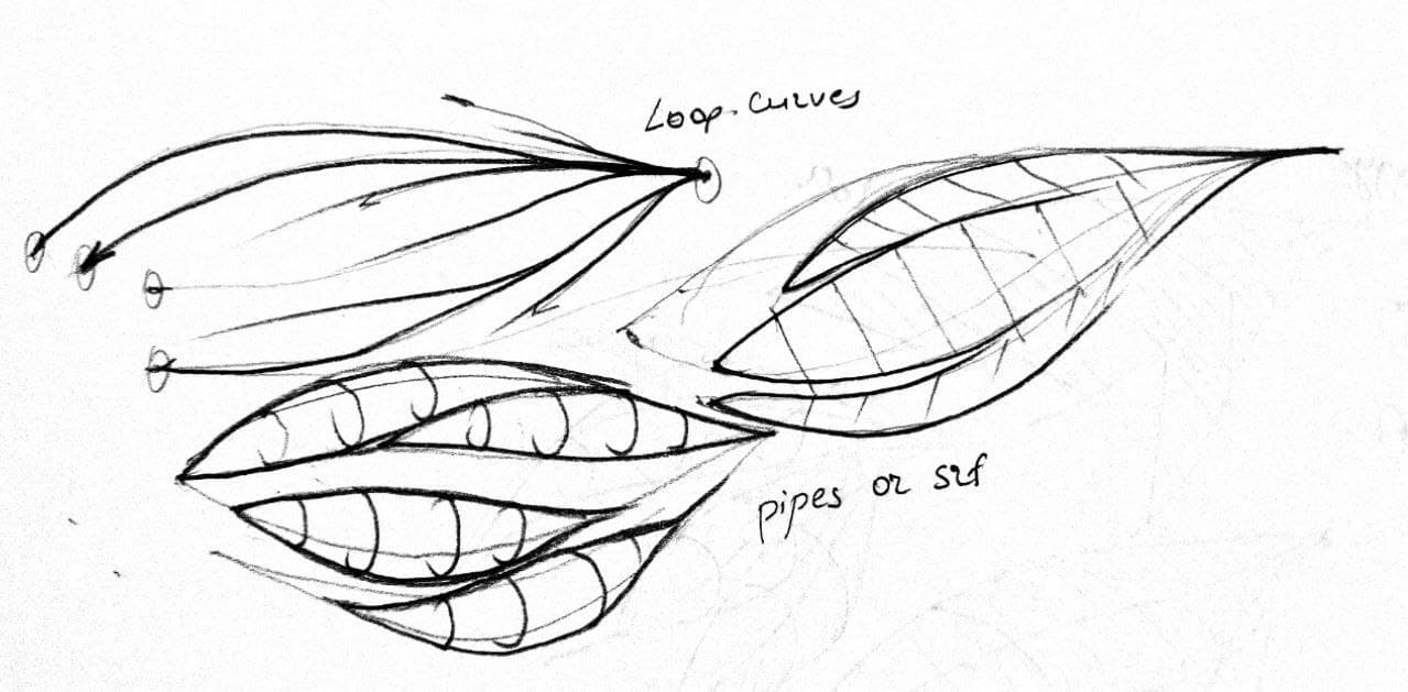

I am currently thinking about how loops in Anemone (branches by looping) can be used to achieve either controlled or unpredictable three-dimensional growth of curves, which can then be transformed into enclosed shells or tubular flower structures. How can an algorithm be organized in such a way that the result resembles a quick block-out in hard-surface modeling, creating a base form for further detailing?
I am sketching out a general concept and trying to understand how to create an evolving system of curves that later connect (for example, via loft) into organic surfaces resembling petals. Is it possible to integrate Kangaroo to simulate the stretching and unfolding of plates and membranes, mimicking the opening of petals or origami?
Eventually, I plan to transfer all of this into Houdini and Maya for post-processing. However, I don’t want to dive straight into Houdini just yet, which is why I started this discussion… :dizzy:
If my requirements and questions seem too complex, unusual, or overly intricate, I can pause the discussion and put it on hold for now… :relieved:

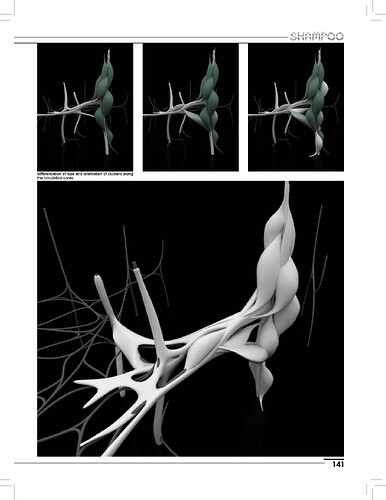

Yes, I plan to use T-splines at the next stage when the petals (surfaces, membranes along curves) take shape. They might emerge from the T-spline structures themselves, forming a porous, adaptive shell. This concept aligns with biomorphic principles, similar to the experimental approaches seen in AA DRL.
For now, the project isn’t tied to a specific location—it’s more of a virtual space, a mini-metaverse where one can immerse, interact, and reflect. It’s akin to a Metaverse Biennale, but on a smaller scale. In the future, these Bio-Integrated strategies could be adapted for real urban environments, organic residential complexes, and terrain-based structures—an ambitious yet beautiful utopian vision. Interestingly, last year there was a Metaverse Biennale (The First Metaverse Architecture Biennale | ArchDaily).
The project is based on stigmergy, bionic growth, and heliotropism. Initially, the space is infused with dynamic energy, akin to swarm systems. From these chaotic structures (a network of curves), petals and leaves (surfaces, meshes) unfold, while tubes and roots (T-splines) emerge between them. The process is not static—this is a digital organism that lives, grows, branches, unfolds, and adapts, transcending the limitations of physical kinetic sculptures.
This is a fast-paced experiment that might later become part of a digital biennale. I’m working with a team of architects and 3D artists, exploring procedural form generation in Grasshopper. Ideally, I have about a month—until the end of March. At the same time, I’m also experimenting with Houdini; it’s a complementary approach, leveraging different tools for a unified process.
I don’t want to manually design and model everything—I’m focused on generativity, variability, and adaptability. The goal is to develop an algorithm that can be deployed in any environment, generating a dynamic network of curves with volumetric growths and aggregations. It’s about creating a living system, not just a static form.
