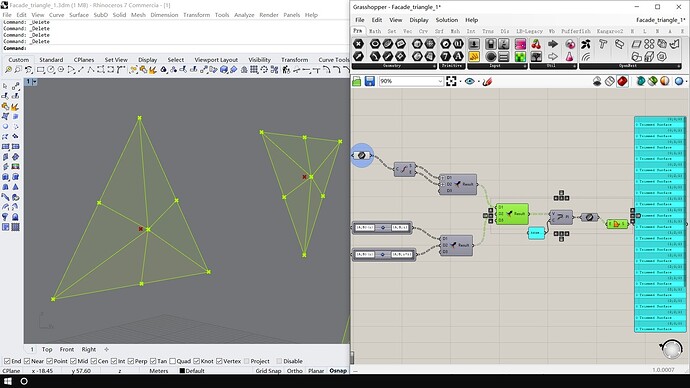

Panels are created. Let’s bake them to check their direction
As you can see each set of faces has a reversed one (Because surface direction is decided by boundary point direction, and anticlockwise point direction is considered front). We have to unify them…
We need to create referencing surface to flip them , so let’s get back here and create these “large triangles” with neighbor edges, then bake to check their face direction…
Turns out it’s their back side…

Bake again, now “large triangles” are flipped as we wanted!
now we flip these “panel triangles” with “large triangles” as guide.
Bake !
And perfect !

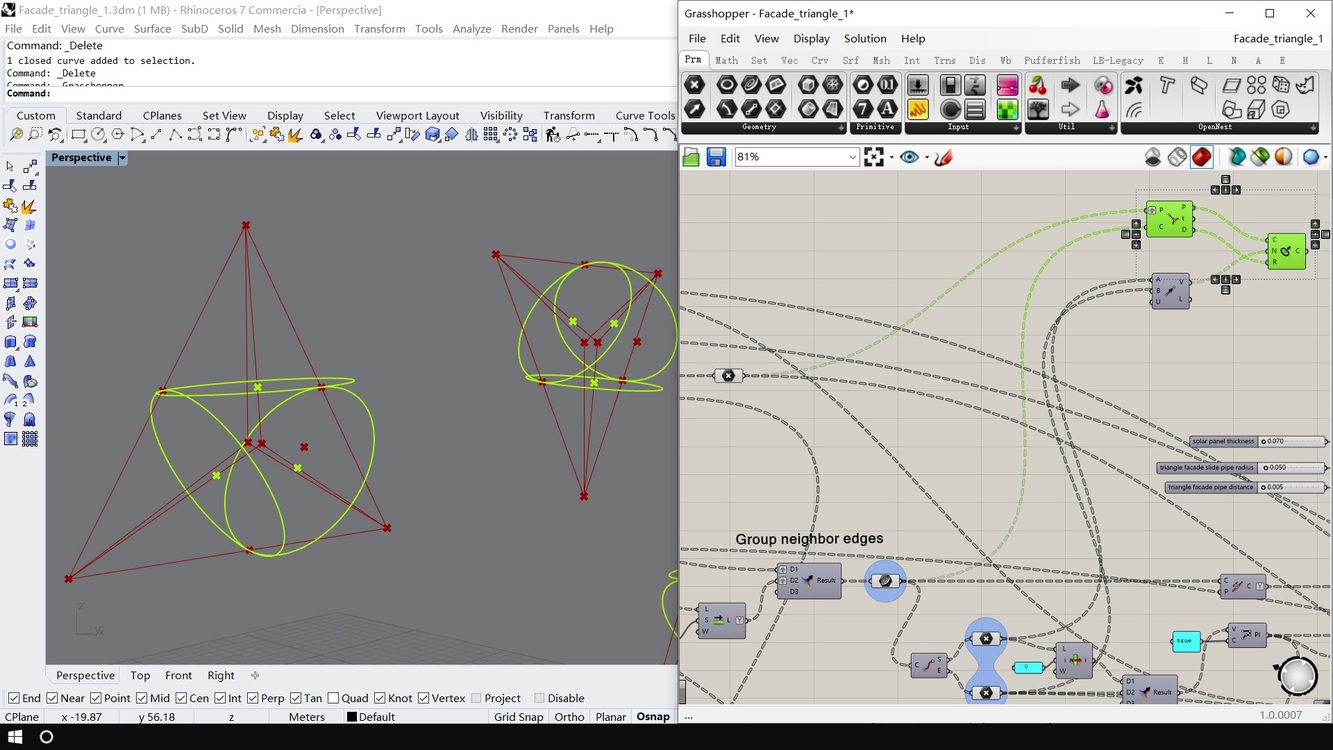

Step 9.
Now, the most challenging part: Make them foldable.
While convex centers elevating, one side of “bone edges” will be elevated upwards meanwhile the other side will be sliding on rails on mesh plane.
Panels are hard plates, which means they can’t be stretched, so they must move with “bone edges”, and fold inwards at the same time.
For this, we need 3 points to locate panel movement: “convex center”, “folding points” and “sliding points” (Don’t worry, I’ll make these clear)
Here, remember “folding points” in Step 4? We need them again. Get the projection distance of each folding point, and find shortest distance in each group. This distance is for deciding the maximum elevation height.
Why do we need this?
Because “elevation height” can’t be a random number, or panels may collide or can’t completely open. We need a solid way to find it.
OK, but why “shortest”?
In this case each triangle is equilateral triangle, so all 3 distances are equal. But in real project these triangles may be distorted, when you apply this to non-equilateral triangles, these 3 distances are not equal, to avoid colliding, we can only elevate them by the shortest distance.
Elevate “mesh center” along mesh normal by elevation height.
Now we have “mesh center”, “convex center” and “elevated center”. We need to repeat them (by 3) to match the number of edges

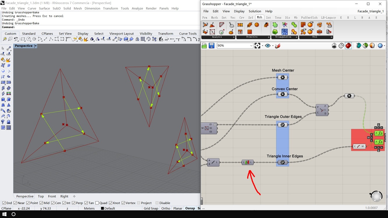

Step 10.
Now, take “triangle inner edges” and get the number of edges in each set (which is 3).
Actually, you don’t need this step, just use fixed number “3” if you like.
I did this in order to make this system flexible for future enhancement (Such as change triangle to quad…). After all, fixed number in procedural design is always unreliable.
Now we have repeated points in each group by 3.
Use “mesh center” to make lines on base mesh, they are the rails that “bone edges” will slide on. We call them “base rails”.
But how do we know where the sliding point lies?
Use sphere to intersect with “base rails”.
The length of the “bone edges” are fixed, so we generate sphere on “elevated center” with radius equal to length of corresponding “bone edge”
Now we have intersections as “sliding points”
Then we also need the points to match the list structure of “grouped neighbor edges”, so we use this trick to make their list structure match (make plane, then extract center).
Connect “elevated center” with “sliding points”.
Now we have located the “bone edges” !
Animation works fine
