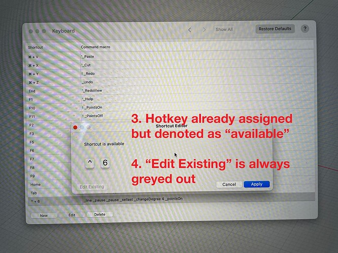

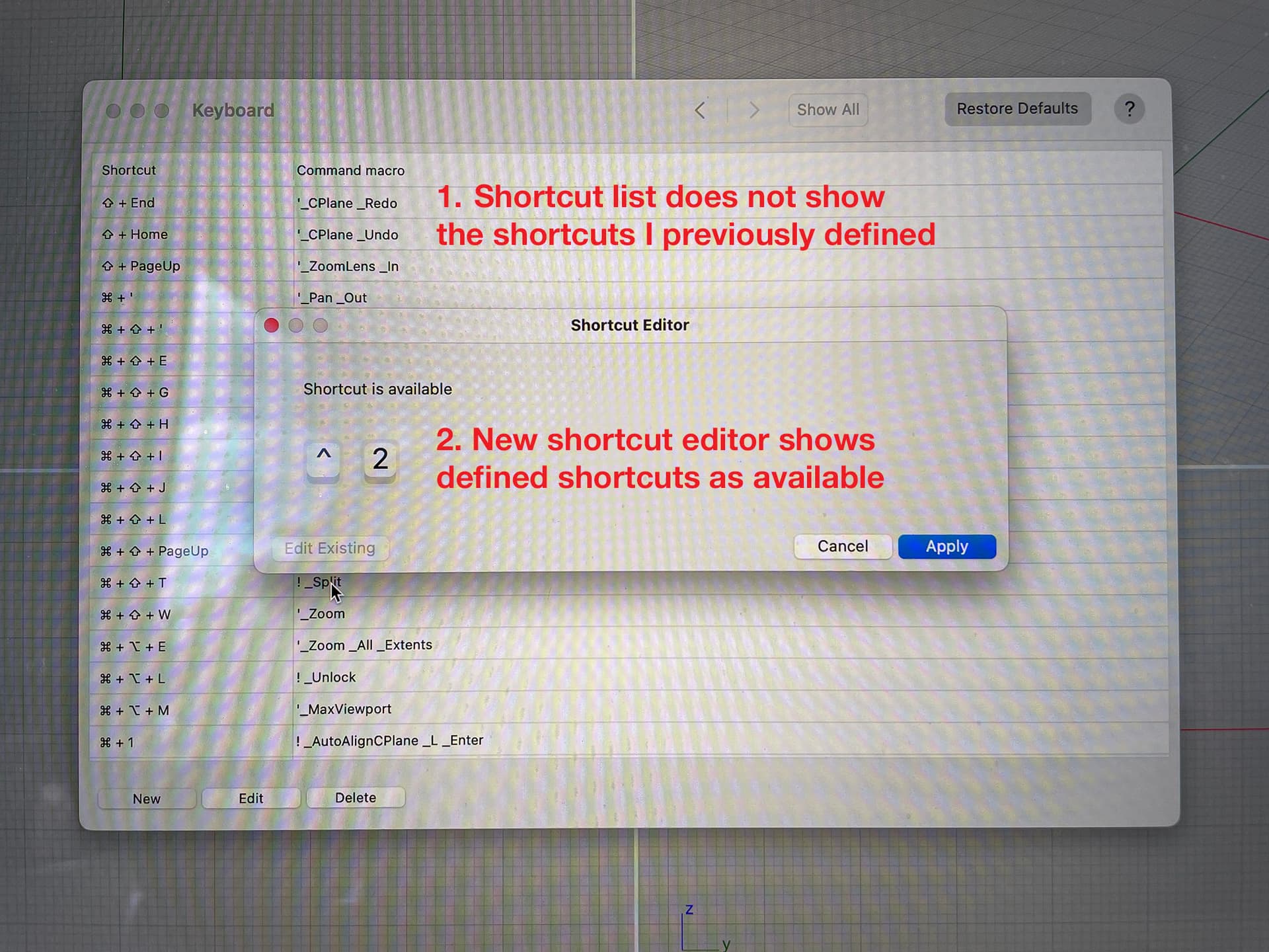

  1. Previously defined keyboard shortcuts don’t show up in the keyboard shortcuts list, yet they work and
  2. previously defined keyboard shortcuts are shown as available while they are not.

I cannot reproduce it here on my end. Once I create a shortcut, it appears in the list and stays there. And if I try to create a new, it shows as in use. I’m confused what might cause this. Could you see if this problem persists if you run the latest SR?

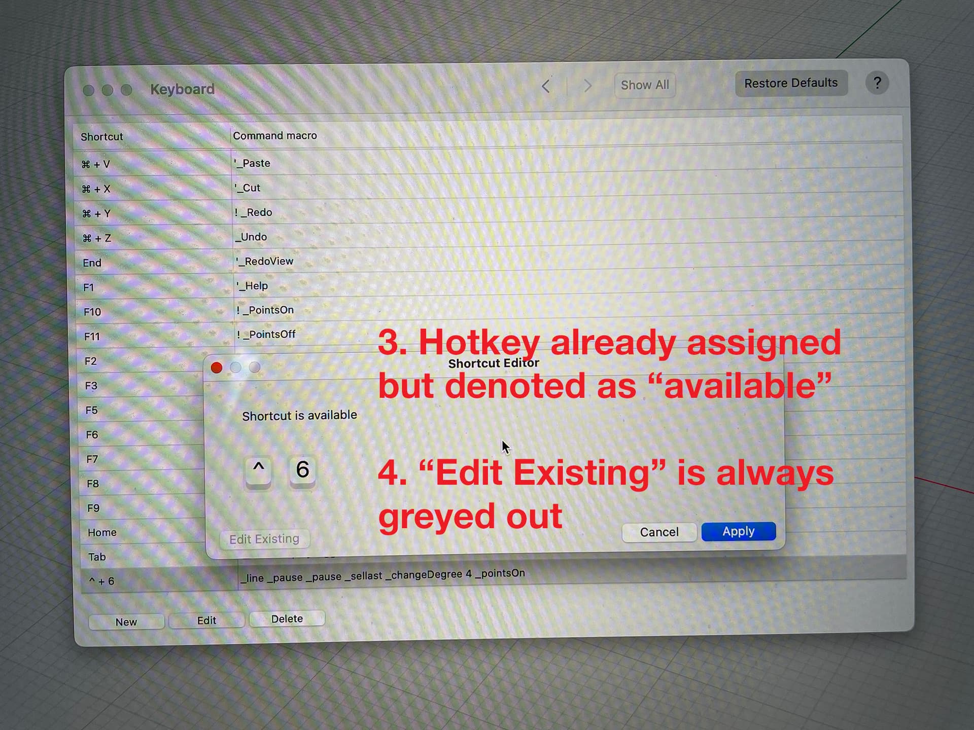

Same thing after updating to the latest version. For example, I press “control” and “5” to draw a degree 5 curve with two clicks and points on for subsequent manipulation. However, this hotkey (like many others) I already used in V7 does not show in the “Keyboard” list.
I can define a new one, and it is retained. However, when in the editor again, that combination is shown as “available” although it is not (or I would accidentally overwrite the command macro already there). The “Edit Existing” button is always greyed out.

I see what you are doing differently, this is the second time I see this. I’ll write up a YT for it.
For now, instead of clicking the shortcut and then Edit, either:
-edit the macro directly
or press the New button then press the shortcut key combo, and the Edit Existing should be available

Yes, editing the macro directly does work (it worked in the past).
If I press the “New” button, then a shortcut combo, “Edit Existing” remains greyed out.
just to be sure, for example, New > Cmd+A > Doesn’t show “Edit Existing”?
For your reference, in V7 macOS, custom hotkeys are shown in the list as expected. So, V8 still “has them”… but where?
With that combination, “Edit Existing” is clickable.
I see, so these are keyboard shortcuts you transferred from Rhino 7, correct? Can you send me the settings that I need to import to reproduce this issue?
Sure, what V7 macOS settings do you need - a zipped “settings” folder?
How did you transfer those keyboard shortcuts from Rhino 7 to Rhino 8? If that was by importing a settings file, then I’d need that settings file.
Here it is.
options_export_v7.plist (511.6 KB)
The file you had seemed to have no shortcuts, so I created one in Rhino 7 for Ctrl+2 and could reproduce the issue.
RH-89706 Importing plist imports shortcuts but they are not visible
