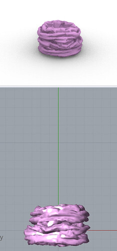

Hi, I tried to use your deflate gh file to try to do something similar, with a sort of pumpkin balloon shape. But still don’t get even the similar shape of it. Do you have any recommendations?
1.gh (40.6 KB)
1.3dm (1.6 MB)
1.gh (14.0 KB)
Hi @lucianatenorio
Here are some adjustments to your file showing how to set up the mesh so it deflates and inflates.

Thanks, @DanielPiker do you know how to make my model not to collapse under the floor level, now it seems as the object deflates it comes under the 0,0,0 level
kangaroo and karamba spb.gh (91.4 KB)
