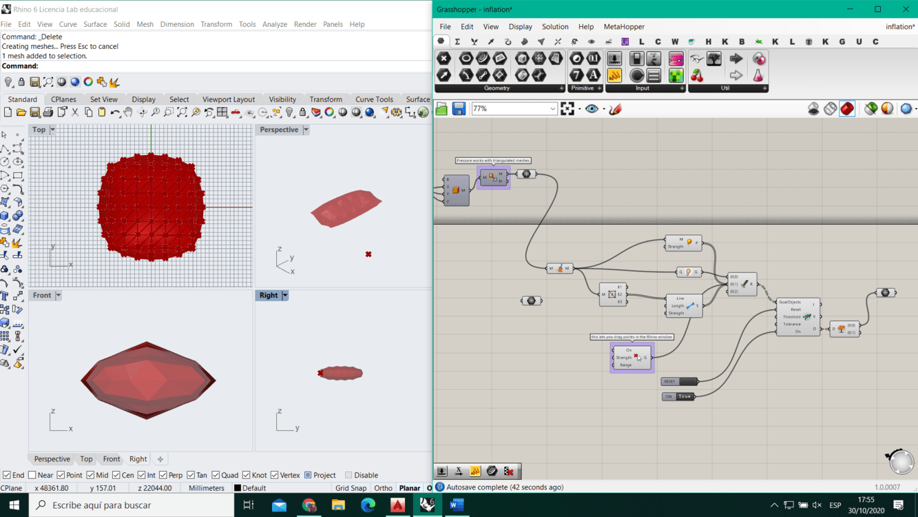

I have some trouble inflating my mesh, somehow the shape doesn’t change, I did it before with a box and it works. I don’t know what I’m doing wrong

The shape in your image looks inflated and like it is working.
You might want to use a higher subdivision level to get a smoother surface.
I also recommend using the Weaverbird ‘Stellate’ component with the distance set to 0 to triangulate the quad faces. This splits each quad into 4 triangles symmetrically, whereas the default triangulation can introduce a directional bias that can cause the resulting inflated form to twist in unwanted ways.

The square is inflated but the other one (the rectangular/origami mesh) isn`t inflating, remains the same shape
It helps to add a few anchor points. You need to attach it somewhere :slight_smile:
LunarBase_inflate.gh (20.1 KB)

I just found out Stellate is the key for pressure to work normally.
