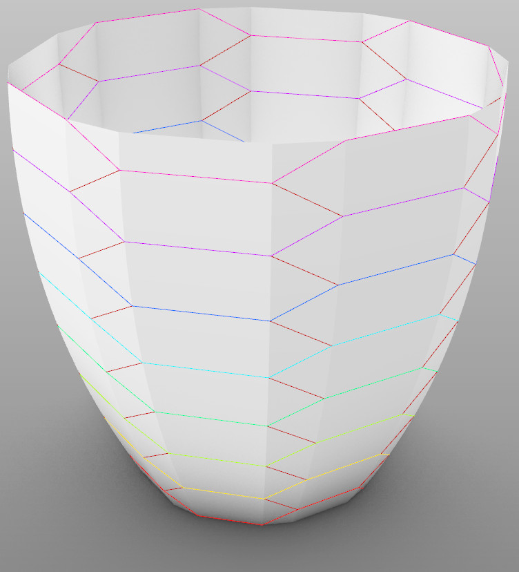

Joining curves between different levels
I’m trying to connect the top landing of the lower level to the bottom landing of the upper level, but I am having some issues. Could I get some help on this?
The Vessel Grasshopper.gh (32.1 KB)
For one thing, it looks like Join Curves failed:
I disabled some of your code and wrote this white group to create the zig-zag lines:
Vessel _2024_Jul10a.gh (39.6 KB)
P.S. The orange group creates half the connecting diagonals between layers. I’m tempted to cluster part of it that must be duplicated to make the other four. :thinking:
Vessel _2024_Jul10b.gh (55.3 KB)
P.P.S. I copy/pasted the code first to make sure it would work, then created a Diags cluster and used it twice.
Vessel _2024_Jul10c.gh (66.9 KB)
Internals of the Diags cluster:
I don’t know if you intend to use this “Master Form” vessel but maybe these polylines should be “pulled” to that curved surface somehow?
Or maybe not?
