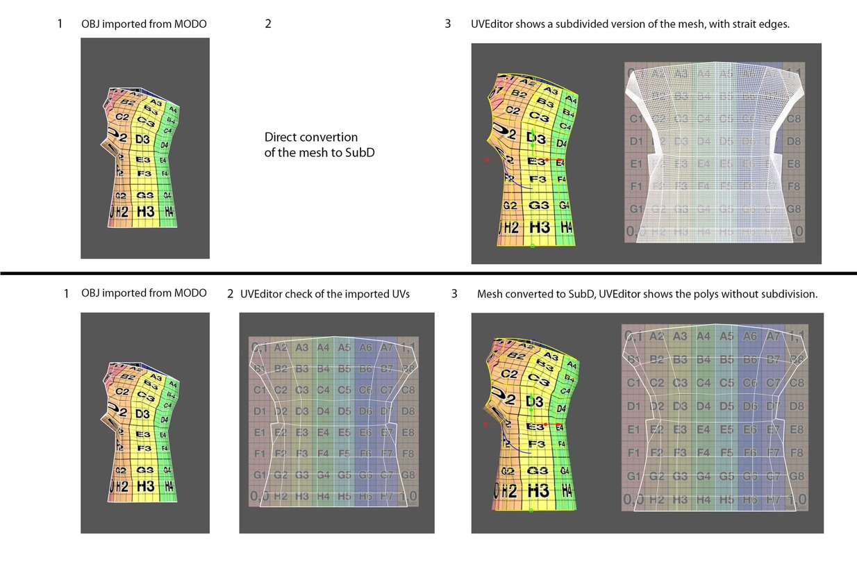

I found a strange behavior of the UVeditor depending on the order you use it.
If you check the Modo mesh first in UVeditor and then convert it to SubD, the editor shows a non-divided mesh, but if you convert the original mesh directly to SubD the result is subdivided.
The way UVEditor works is causing lots of confusion.
When you start the UVEditor you see two meshes:
  1. The mesh that substitutes the object itself and previews how the UV’s look in 3d
  2. Flat meshes in UV space that you can edit
Those meshes are generated based on either
  1. custom mesh mapping primitive if selected channel has Custom object mapping,
  2. low level subdivision render mesh if object is a SubD or
  3. the object render mesh.
Custom object mapping is applied as soon as you click on Apply on the UVEditor or when you run Unwrap.
So if you run UVEditor on the imported mesh and click Apply then from that on the object has a custom object mapping with a copy of that mesh as the custom mapping primitive. And when you then make a SubD from that mesh object that new SubD will have the exact same custom object mapping with that same mesh primitive.
