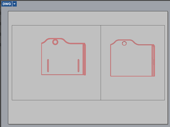

Hi All,
There are some curves freshly pulled onto the surfaces.
In Technical DM those curves are partially recognized as hidden and as a result printed dashed.
My workflow is to have hidden lines off so I have partially missing words in resulting PDF.
Also PrintDisplay shows text in full. I don’t trust it anymore.
For instance, Shaded DM makes full text visible in printed PDF.
I understand, it’s a different display pipeline.
I would highly appreciate two things: curves on surfaces printed correctly and proper work of PrintDisplay.
PrintDisplay:
Technical DM PDF (with hidden lines off)
Shaded DM
Sample file is attached.
450.3dm (1.1 MB)

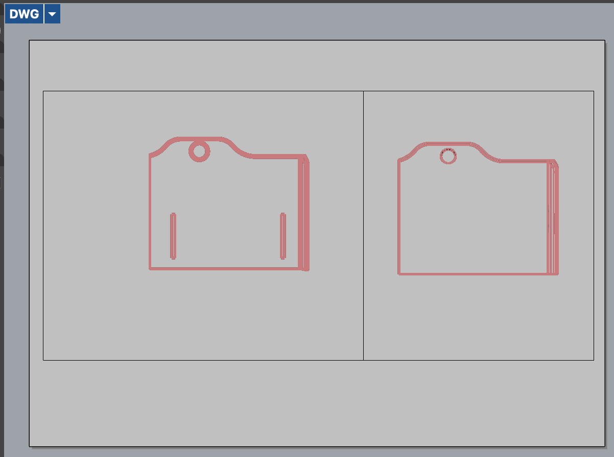

My Technical DM is modified to show no edges (creases, silhouettes). Just curves.
But output PDF still has edges shown.
Is it possible to get rid of edges?

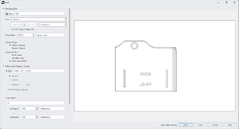

DM settings and layout view:
Print dialog:
Resulting PDF:
Hi Screamer -
No, that doesn’t appear to be possible.
I’ve put this on the list as RH-87047 Print: Vector Print Prints Turned Off Edges

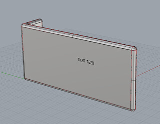

Unfortunately, I have another Technical DM issue with curves on surfaces. Now it’s read thru.
Could you please try to reproduce?
The file is attached.
1111.3dm (3.7 MB)

Hey Screamer -
I’m seeing that in your file, but I can’t reproduce this from scratch.
I’m just getting a spinning wheel when I try to run your video so I don’t know if that gets into the details of how to reproduce this.

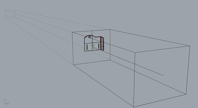

When I turn on the camera of your detail, it looks like this:
When I do the same with the “Right” viewport, it looks like this:
(in both cases, I have moved the camera point closer to the object - the point is the dashed line).
When I place a new detail on the layout and set that to the Right view, everything works as expected.
I’m seeing something else going on as well and will get that on the list ( RH-87161), but could you provide instructions on how to get a detail’s camera to behave like the one in your file?

So, in order to replicate the issue, here is the instruction below (working on the same file, attached couple posts above):
0. Let’s delete any detail from the layout.
  1. Create a detail. Activate it. I make it Shaded for better managing.
  2. I make it Perspective first, for easy picking of surface I need.
  3. Activate Auto Cplane. Ctrl+Shift+Click on the front face.
  4. Keeping Ctrl+Shift pressed, start View rotation with RMB. Release keyboard buttons and then push it back while keeping RMB pressed. This should align view perpendicular to the CPlane (to the selected face in our case)
  5. Change the display mode to Technical. Activate layout. Try to print. Here we are. Text is see thru now.

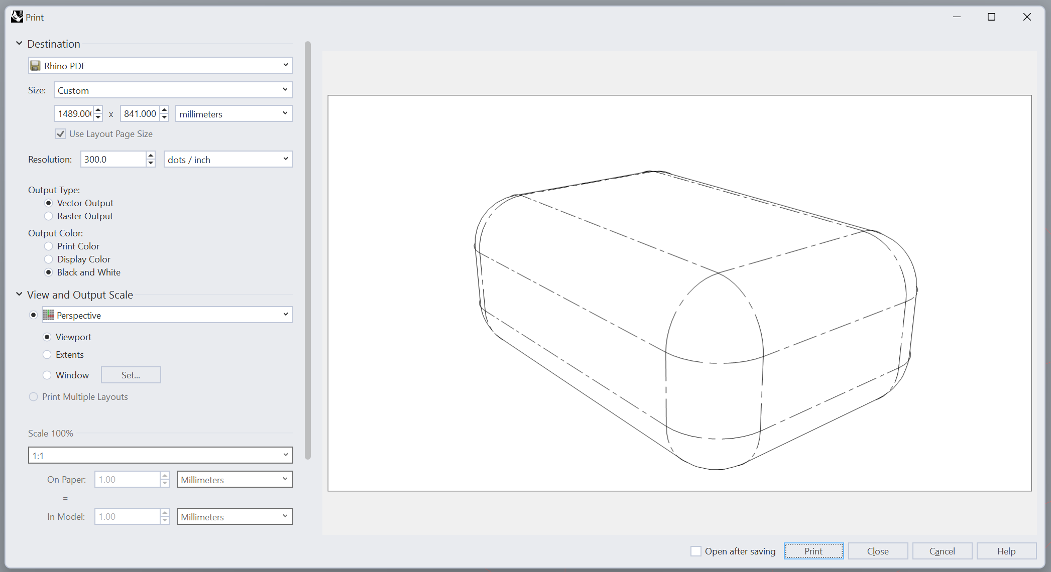

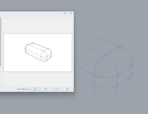

Also, I want to bring your attantion to this effect:
On a new file I created a simple box. Make fillet edges, create duplicated edge curves.
Technical
Try to print preview this scene in different zoom levels.
Here is what I have as results.
There are some non-occluded or missing curves at different zoom levels.
This should work at any zoom level.
