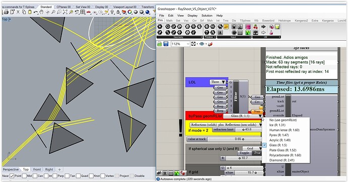

You can’t do that (general case: anything around [open, closed Breps] + multi ray bending with regard all present Breps) without some sort of loop technique (in coding the most efficient is recursion). Anyway, found 15 minutes more to continue on that.
2 modes would be available: Multi Reflection or Multi Refraction (on solids) + Multi Reflection (BrepFaces). See some WIP results here: (either reflection or refraction):
BTW: A critical angle filter is obviously a must (when a refraction becomes reflection):
BTW: I must manage far shorter times: 13 milliseconds are a lot for such a simple task (blame the Brep Normal Method).

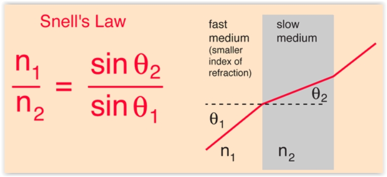

Here’s a very simple demo thingy on that Snell law. You can do it obviously witth native components (but the other things that the forthcoming C# does … well … er … you can’t).
BTW: angleIn is the Vector3d angle between the Brep Normal (inversed if ray is inside) and the rayDirection (always inversed) with respect a plane defined from the hit point (origin) and the CrossProduct (rayDirection, Normal). Google: CrossProduct and given the opportunity do the DotProduct search as well. There’s native GH stuff on these I believe.
RayShoot_SnellLawDemo.gh (9.1 KB)
Observe that going from air to some material (with some R) is OK … but the other thing MAY or MAY NOT yield an “escaped ray”. If the ray is trapped inside we have a reflection (life sucks).
This means that the critical angle is related with the rayState (in/out) AND the angleIN AND the R value … meaning that there’s no need to include it as var (if the NaN test is considered an “elegant” way to cut the mustard) - NaN means Not a Number.

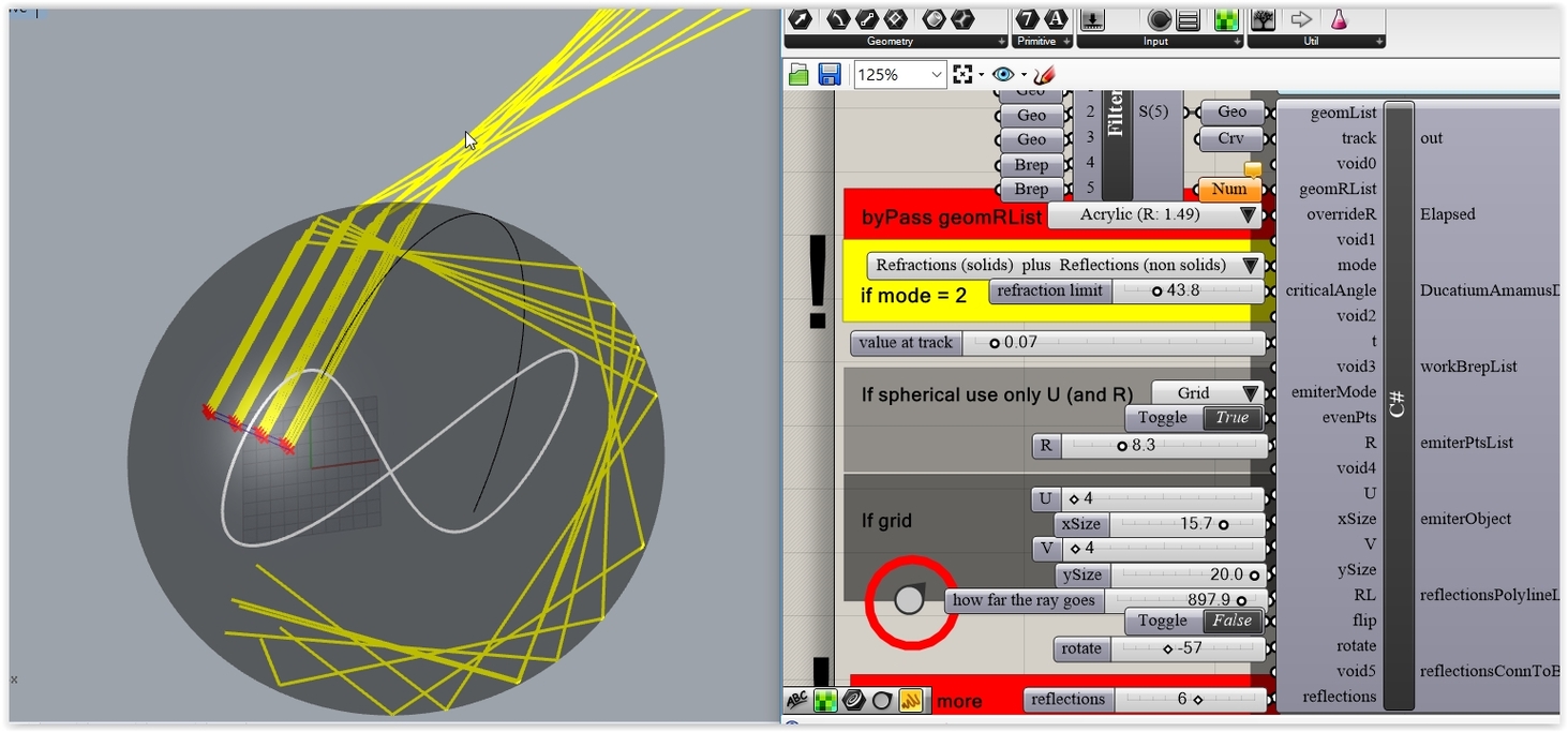

Here’s a visual demo on that trapped inside (Refraction) ray matter. Shooting from the inside of a Sphere that has R values (see overrideR) from 1.31 (Ice) to 2.41 (diamond). As the R grows less and less rays can escape … and for these values/settings captured and for that emit Topology diamond yields the same results as Mode 1 (Reflection).
That’s why girls like diamonds meaning that we should work overnight in order to offer them the best of the best.
