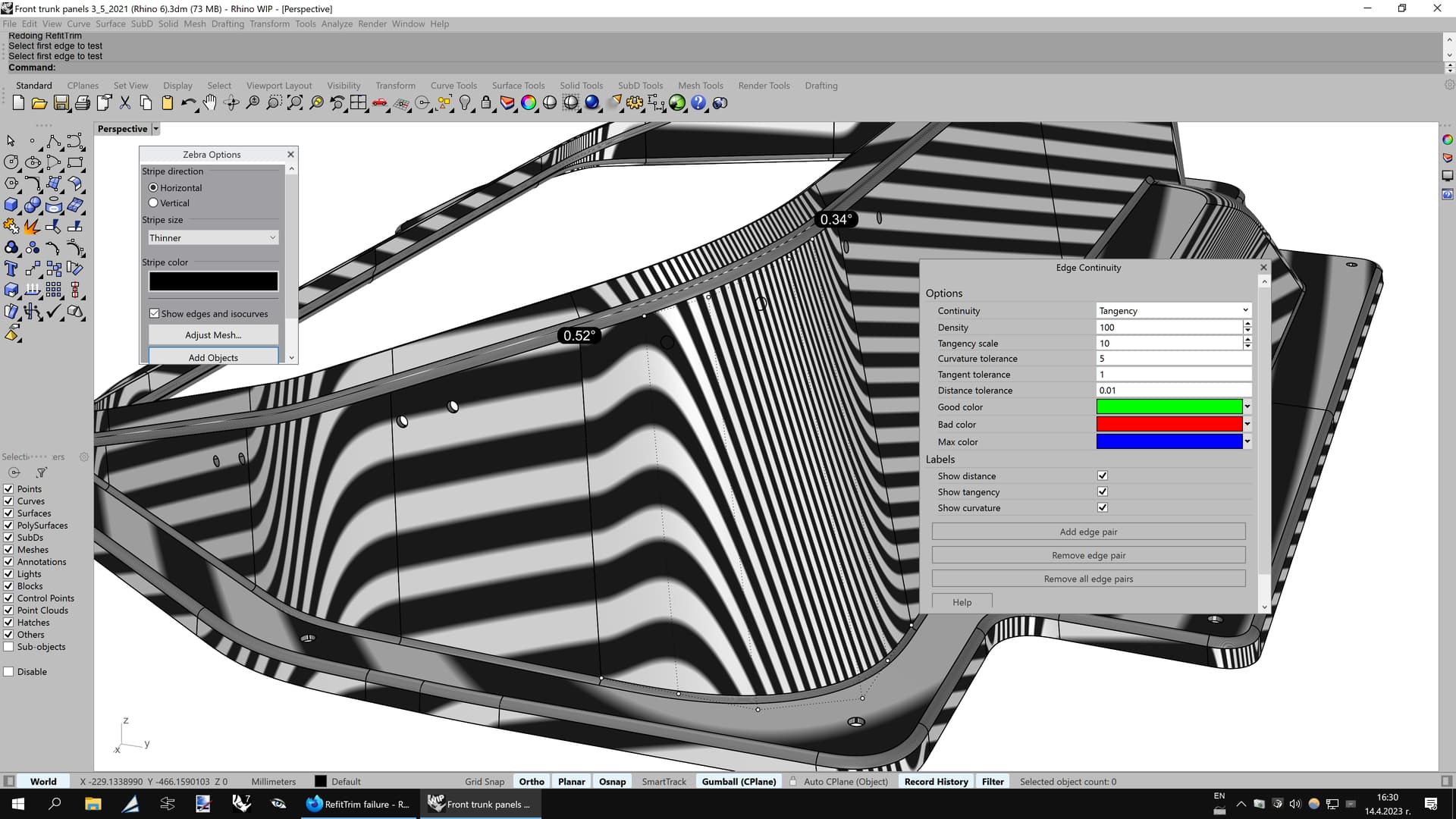

I played a bit with the same tool on Rhino 8 WIP and it performs better, but still produces some deviations that should not be there. For example, applying “RefitTrim” to a straight blend between one vertical and one horizontal surfaces resulted into deviation up to 0,4 degrees, which is weird, because the only thing that the tool had to do is to slide the control points of the converted surface sideways and maintain the G2 continuity. The good news is that “RefitTrim” is better in Rhino 8 WIP, the bad news is that it will forever remain almost unusable in Rhino 7 (unless multiple “Match surface” operations are added to fix the huge deviations at the other 3 ends of the surface).
I just made another test of “RefitTrim” in Rhino 8 WIP and must say that it still fails to do the job properly on the same model where Rhino 7’s “RefitTrim” also failed. Basically same behaviour on the same 3d model, with a deviation up to 0,52 degrees. This is way too much of a deviation for a simple blend surface created between two planar surfaces. Looks like those claimed improvements of “RefitTrim” in Rhino 8 WIP are limited to rare scenarios.
Before “RefitTrim”:
After “RefitTrim”:
Before “RefitTrim”:
After “RefitTrim”:

Rhino 8 WIP’s improved “RefitTrim” resulted in 0,34 degrees deviation on the right edge, while Rhino 7 did it a bit worse at 0,37 degrees. Both are unusable. Manually sliding those control points along the vertical direction of the control polygon with “MoveUVN” let me maintain perfect G2 continuity.
