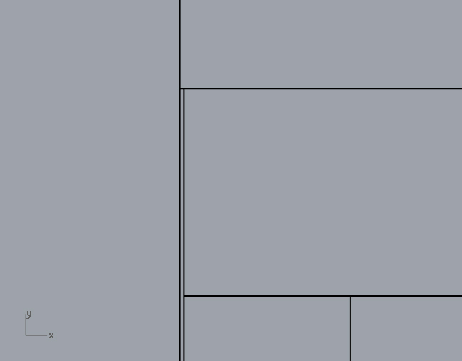

Doors and windows are not strictly aligned with walls. Misalignment is 1 mm.
What is the reason and can you fix it?
Zoomed top part:
Zoomed top part:
Hi Gvanka,
Is this happening to you with all the window/door styles?
If you send the file to visualarq@asuni.com we will ckech the issue.
Thank you
Yes, with all.
Here is an example:
Misalignment.3dm (2.6 MB)
Yes there is something wrong with the tolerance, we will take a look at this issue.
For now if you increase the precision to 0.1 mm it should work fine for any new doors / windows, for the existing ones just select them and run _vaUpdate.
@gvanka, this issue has been fixed in VisualARQ 2.5: VisualARQ 2 - Version 2.5 released
