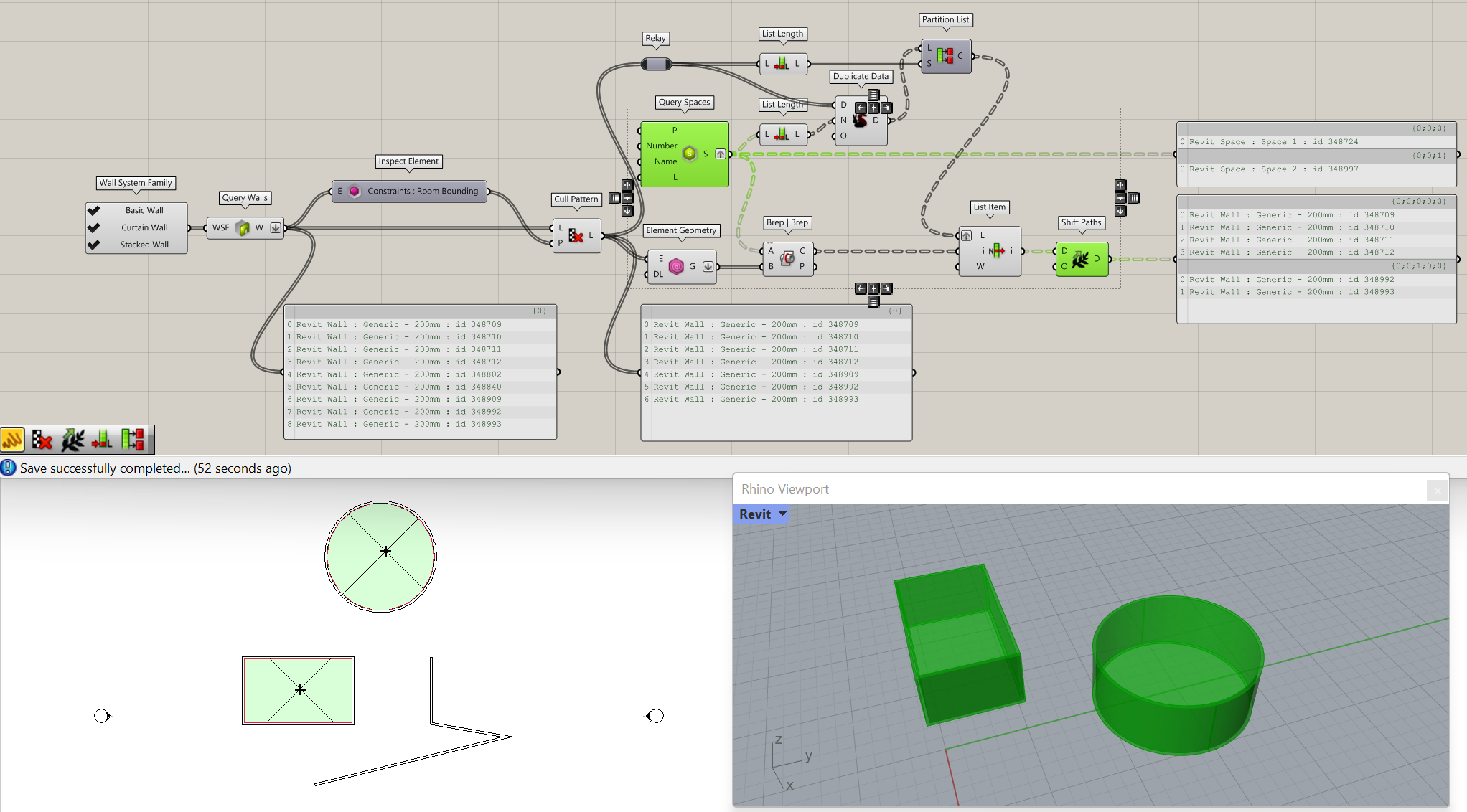

I am currently working on a similar project in which im trying to export geometry from Revit using rhino inside revit. I created the spaces in order to transfer the thermal information that comes with it but when i export it to rhino i get the spaces but no wall so they are floating and have no way to run a better analysis. Did you manage to create the honey bee rooms ?
Hey @anab_95 ,
If you are trying to get space bounding geometry into Rhino, then you can use the attached sample to extract the walls, and in the same manner you can extract ceilings, roofs and floors… Also you can note that if you have a single wall that is associated with multiple rooms, then you would have it appearing multiple times in the result, so what you can do depending on your needs is just flattening the final list and use the “Create Set” component to have it only once.
hope that helps you, and if you need further help, maybe you can provide more detail on what you are trying to get from Revit’s side and in what sort.
Space_BoundingGeometry.gh (23.0 KB)
