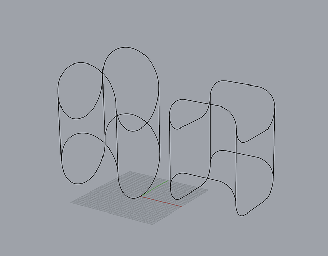

Hi guys,
Sorry to have to turn to the forum.
I’m wondering what tool you think I could use to get these wireframes into a shape like the screenshot?
I’m very interested in ‘soft cell’ shapes having come across this article.
I imagine this is a Sub-D question — but I can’t get the loft tool to produce the desired results, as I need to loft all four faces?
Any suggestions or pointers hugely appreciated!
MDS-SK-001.3dm (2.7 MB)

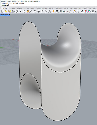

I would not use SubD. SubD surfaces have zero curvature normal to edges and creases while the surfaces shown are curved at the edges.
One method to make these shape.
Simplify the curves.
PlanarSrf to create a planar surface.
ExtrudeSrfAlongCrv
MDS-SK-001 DC01.3dm (2.2 MB)
An alternative would be to split the curves and use ExtrudeCrvAlongCrv several times.

This is brilliant. Thank you so much for this.

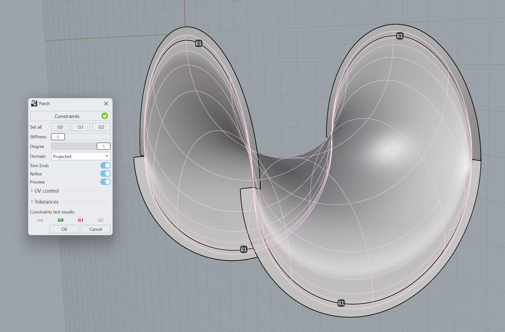

Not strictly minimal surface by definition, just a quick thought leveraging smooth command and CageEdit command with ‘symmetrical’ gumball deforms:
Using just Rhino
c-shape-patch.3dm (1.2 MB)
PS: Rhino 9 WIP…

I tried some more starting with a network surface but could not get the fillets to work.
