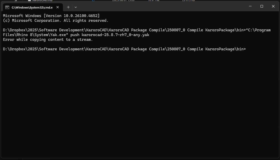

I’ve not been able to upload a .YAK to the package manager for about 18hrs, just get this error after about 5min:
All other online services on my machine are working as usual.
Has someone broken something?

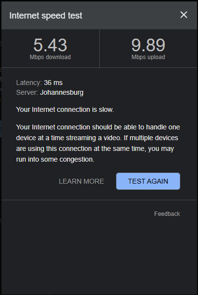

Package Manager uploads are failing for me again:
While my internet connection isn’t “Western World Software Company Office”-fast, it’s been stable and reliable for my work from Cape Town:
This is becoming a serious blocker—especially when I need to quickly push out bug fixes to clients.
Is there anything I can do on my end to resolve this, or is it a known server-side issue?

Any guesses on how many tries it is going to take today:
My download speed is a little slow today, but upload is OK:
However three failures and counting:

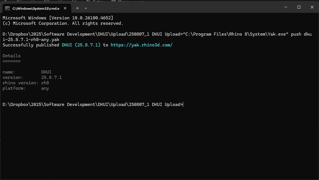

OK - it is for sure some sort of file size/time out issue.
I’ve just uploaded a new version of DKUI (630kB) and it was done first try in a few seconds:
KaroroCAD is 21MB - not exactly a big file in 2025, but much bigger than DKUI.

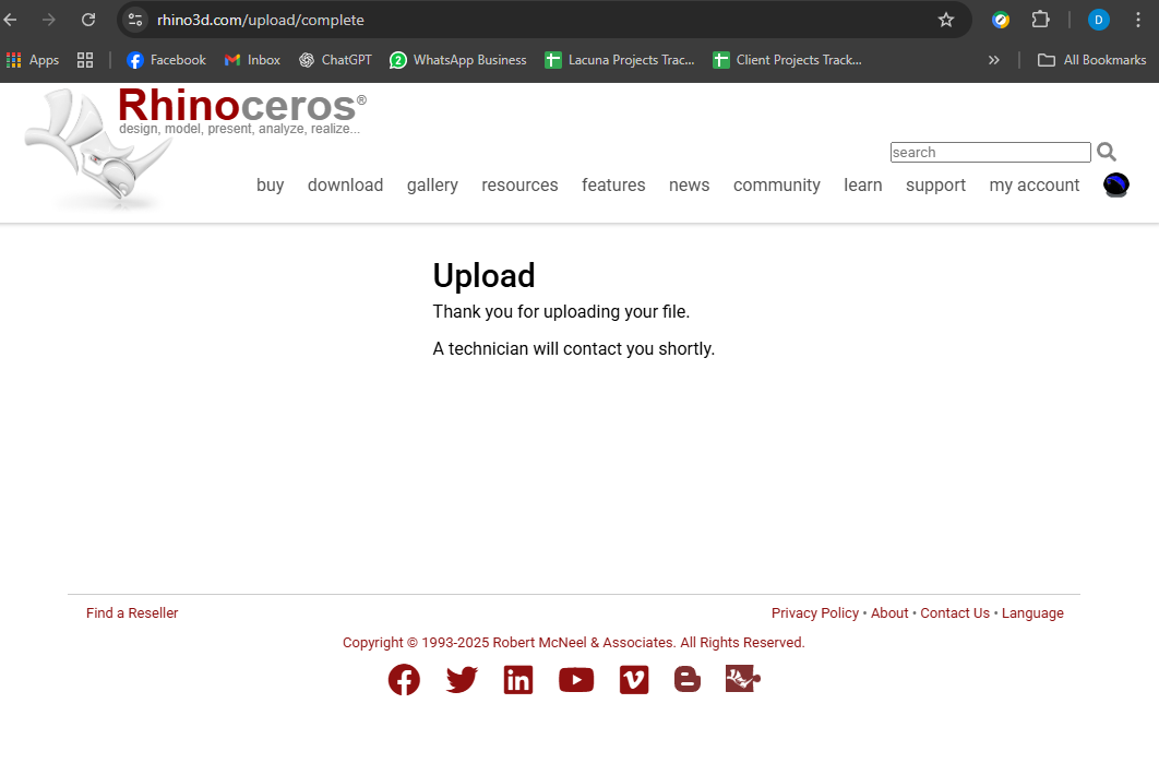

Could you please try uploading one of the KaroroCAD packages to Rhino Accounts and let me know if you notice much of a difference in success rate and/or speed?
Hi Will,
That went fine - took about 20 seconds:

here is a variation in error message
C:\Code\ZebraCutBuilds\Rhino Packages>"C:\Program Files\Rhino 7\System\Yak.exe" push --source https://yak.rhino3d.com zebracut-5.1.5-dev-rh8_19-win.yak
API returned 499 but the error couldn't be deserialised
