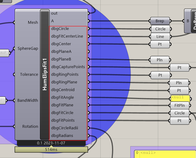

True, but during development I often have a whole bunch of “debug outputs” and dealing with all that takes too much time and messes up the code, only to prevent recalculation.
Look at this horrible although very useful example of “debug ouputs”… :
