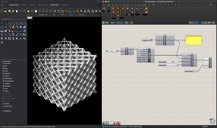

Hello everyone,
I hope you are doing good. I want to create a lattice mesh with variable density. I used IntraLattice to create the shown script but unfortunately don’t have full control of the gradient command. Is it possible to plug in a point and/or curve into the ‘gradient string’ that then increasing/decreases the radius of the lattice structure close to the point/curve ? Maybe even with a Graphmapper for optimal control ?
Thank you for your help!
Intralattice Gradient.gh (6.9 KB)
Please give it a try with Dendro
Intralattice Gradient.gh (11.0 KB)
Intralattice Gradient Edited v0.gh (103.6 KB)

Got it, I think you can give it a try with MultiPipe,
Intralattice Gradient.gh (13.6 KB)
Oh thats great thank you so much! Is there a way to add multiple points or even a curve as attractor ?

Thank you so so much! That helps a lot! I will play around with this script for my projects in the next days. Maybe I will have some more question along the line but for now this is great. I especially like how simple the script still is and the MultiPipe has some great commands like StrutSize and KinkAngle to adjust the final result. Great idea!
