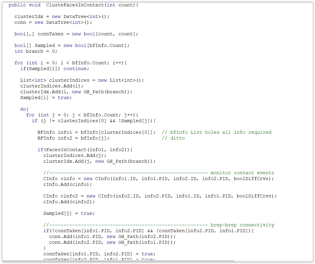

How to get indices of surfaces that were/will be joined from flattened list? like that:
join brep finds collisions so quick and easy in comparison to other methods!
That’s a classic and rather very simple Clustering task where the criterion is the Brep.Join Method. Clustering means a DataTree of Type int where items are the indices of the co-related items (as Breps) in the input collection. Obviously you can use some other criterion (like Brep/Brep proximity and common Face Edge detection (say overlap) … but why make things complex for no reason?)
Say “like” using this into a standard Custering Method (very easy with C#).
Note: in case that you are familiar with coding DON’T attempt Clustering with a “simple” double Loop. Here’s the “basic” approach on that matter (as you can see it’s a very simple piece of code).
I assume, that under the hood “join brep” component finds intersections, it just does not give the indices. I know the maximum we can get is the tolerance change… I need that because i have a building with curves that represent windows. I want to find all the corners, given i have all facades and floors sorted in branches, and order sorted in lists. I would use indices from join brep to find the corner units of the facade.
Thank you, I will try to write that!
Er … hmm … I assume that you are familiar with C#. That said in real life we use “pre-filters” for excluding items that are not “related” (i.e. BEFORE calling some expensive Method like Join).

Wait: since you create all that stuff via some algo … why the pointless reverse engineering part? It’s rather easy to control “ordinary/rnd partitions” on a per horizontal “Interval” basis … meaning that corners (and any other thing imaginable) is easy to spot/locate/manage.

BUT … don’t use it: added a very simple (LOL) 3rd C# that outlines the way to cut the mustard: i.e. deal with the problem at creation time and forget reverse engineering (very rarely justified - LIDAR stuff excluded etc etc).
