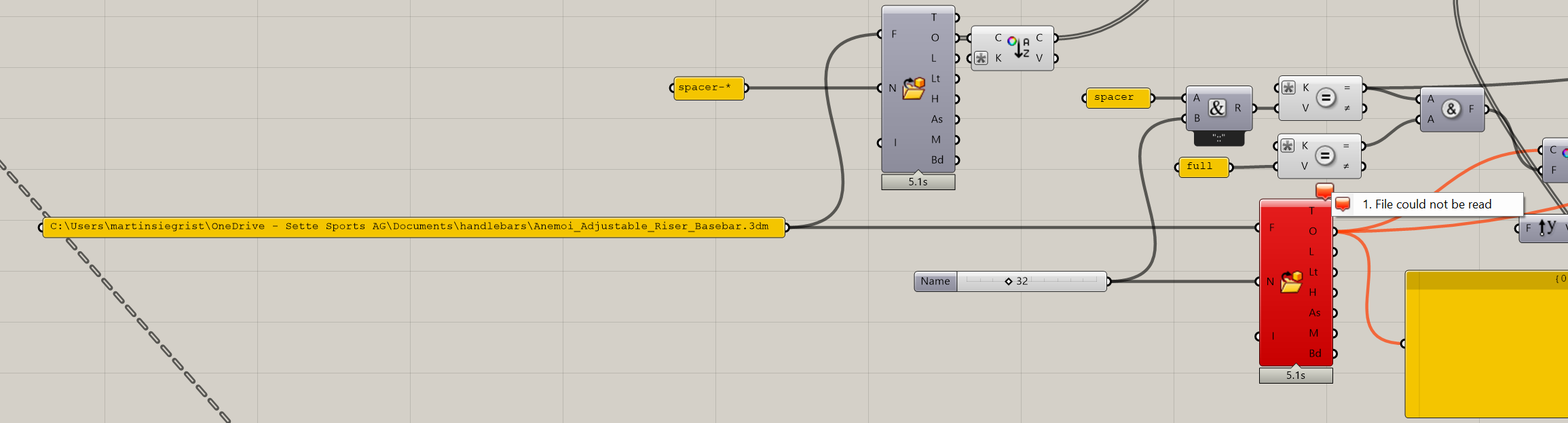

Import Content and Model Block Definition issue
I get this error when loading a huge Grasshopper definition. The file size of Rhino file containing the ‘magnet-cone’ is just 134 KB. When I copy the component it loads the block just fine.
I cannot reproduce the problem in a simplified file and it is weird because there is nothing upstream that could affect the import.
In this case, the same file is used twice. Opening the Grasshopper definition loaded one of them successfully and the other one failed. I created a new wire connection and the import worked. The issue is not about the wire connection, I think this is simply the quickest way to update the component without deactivation or using a button or trigger.
Opening the linked file shows no errors.

Hi @martinsiegrist,
‘Import Model Block Definition’ should be fixed on 8.22.
‘Import Content’ will take more time.

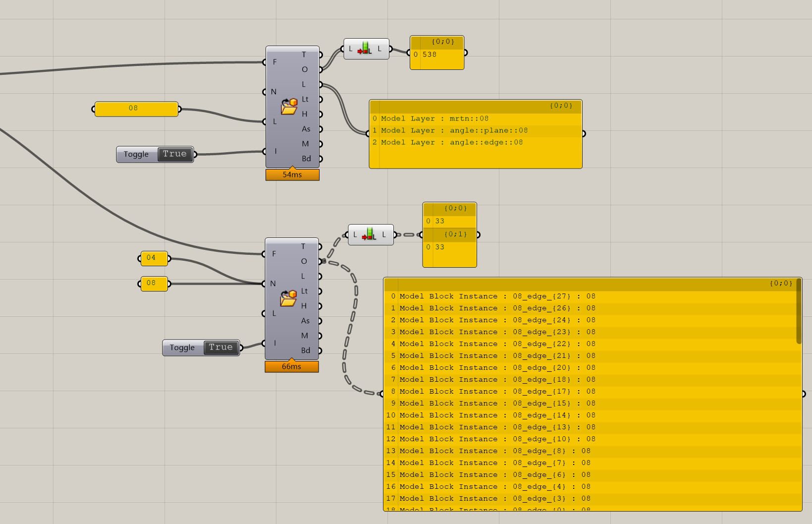

Thanks @kike is there any chance the layer filter input on the Import Content component could work the same way as the name filter?
I don’t see the benefit of importing just the layers. What is that useful for?
When working with heavy files, I think it would be useful to be able to import just the content of certain layers. I can do this by naming all objects in a certain layer with the same name but that does not make sense. It is just a workaround.
Maybe there isn’t even any performance savings to import just some objects?
@kike this is a problem in big definitions. The import component seems to fail randomly. Until it works in a reliable way, I’m using a data dam.
The definition is pretty big and the entire thing is based off of one referenced body scan. The body scan is referenced in a rider specific file which also contains the riders bike and components which are relevant for this definition here. The rider file is referenced twice with name filters. If one of the two component fails to import, a lot of the downstream operations still run. Usually the component works fine when I disable / enable it or plug in a wire again.
This issue seems to occur randomly. I’ve loaded the same big file at least ten times and today the issue was on two import content components which until now always loaded without problems.
Could this be related to using OneDrive ?

The issue is on the list as RH-91593 Import Content issues
In this case yes, all files are Rhino files.
RH-91832 is fixed in Rhino 8 Service Release 29 Release Candidate
