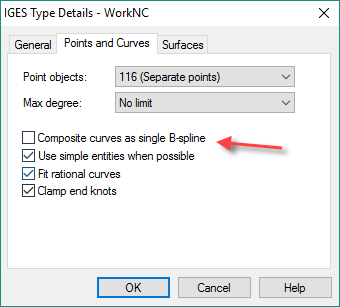

I needed to make an adjustment to the IGES export in Rhino. I now need to distribute this to 130 users. Is there an .ini file somewhere that retains these settings, or is this saved in the registry?
Thanks,
Dan

For V5 that is true. Looks like the key name you care about is HKEY_CURRENT_USER\Software\McNeel\Rhinoceros\5.0x64\Scheme: Default\Plug-ins\7f0ca561-0c7c-4cea-b822-b95ebe71c409\Settings
In V6, it’s an xml file located here. %appdata%\Roaming\McNeel\Rhinoceros\6.0\Plug-ins\IGES Export Plug-in (7f0ca561-0c7c-4cea-b822-b95ebe71c409)\settings\settings-Scheme__Default.xml
