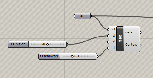

I want to make mesh from Hexagonal grid on any surface. Again the mesh shape should be hexagonal not square or triangle. Please help me, I am completely new to grasshopper
This is the image where I have hex grid over the cylindrical surface. Now I want to convert this gride form to mesh.
Thread title is way too long! Where did you get that Hex component?
Hello Joseph, Thank you so much for your reply. but the solution that you provided do not work for me. Also the Hex component which i have used in the previous post is from a plug in called Lunchbox.
Have a try ngon plugin.
Thank you so much HS_Kim. This solution works perfectly. Many thanks
