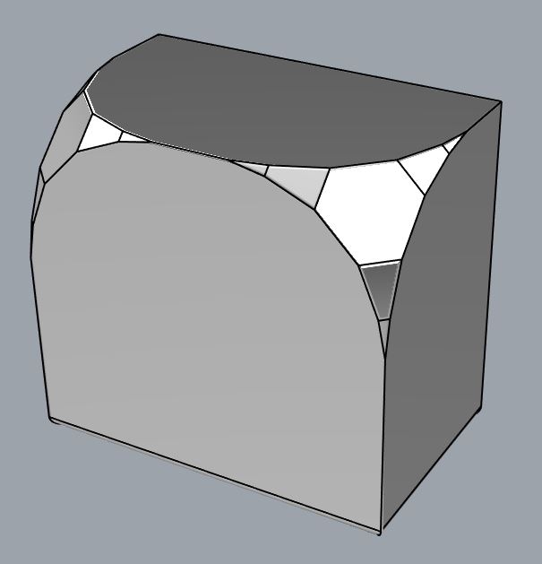

Yeah, I was messing with shapes like that in testing - it makes an interesting and nice progression - I wonder if that shape converges on some predictable shape like a parabola or something.
you might have inadvertently introduced a whole new tool set for v7 ;]
Yelen I think you figured out Pascal’s script-activist ways to get things into new builds :rofl:
