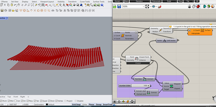

hello i have here a rhino surface that is planar(trapeze shape)and did divide it into points when i move those points in z directions and i try to make a surface out of those point i get the null point in a grid as a notification how can i please make a surface like that please
problem.gh (18.8 KB)
That’s because your base geometry is a trimmed surface(which you didn’t internalise, so I made one…).
In this situation, you could use Copy Trim like this.
problem_re.gh (14.6 KB)
Great thank you so much!!!
