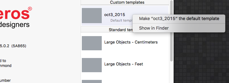

The topic title pretty much sums it up. After carefully creating a workspace I like, I saved it as a template. Later when I tried to use it, it didn’t show up in the splash screen dialogue box. Doesn’t “save as template” automatically place the file in the correct place? Any idea where my templates are going? Which library are they stored in - the user of system?
from the splash screen, make sure you’re viewing templates instead of recents…
or you can go File-> ‘New using template’
the custom template section will be at the top of the list (you may have to scroll up above the default templates)
once you find that, you can right-click on it for the options of setting it to your default (ie- doing File->New will open your custom template) …or, show in finder. (which will take you to the place where they’re stored… that being here:

Okay, thanks Jeff. I’ve just recently installed the commercial version over the wip I’d been using. Maybe that’s left some remnant associations that are messing the system up.
Any movement on this thing? Anybody?
The template name must be a valid OS X file name, and MM-05/05/10 is not valid filename because it has slashes. I’ll file a bug about checking template names for invalid characters.
