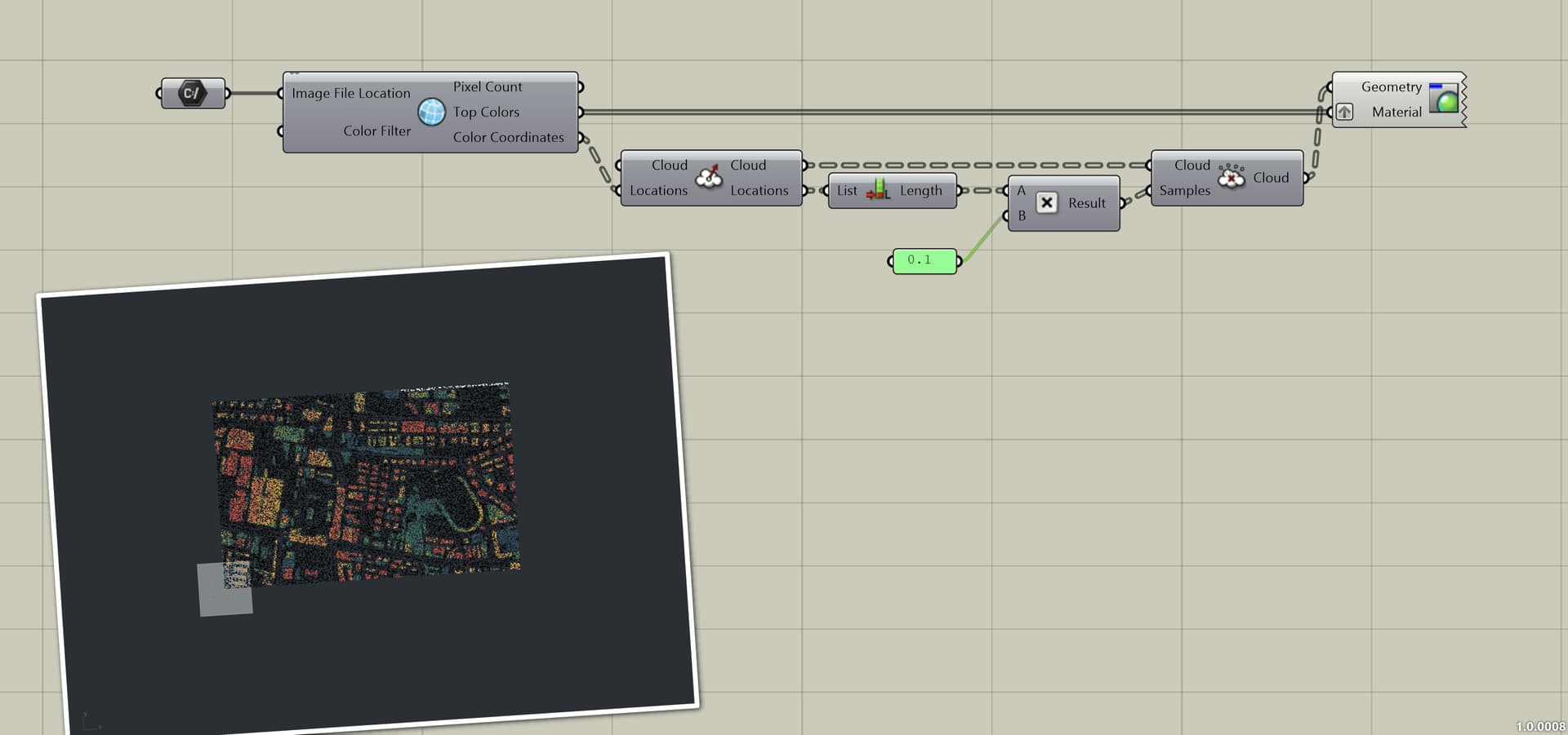

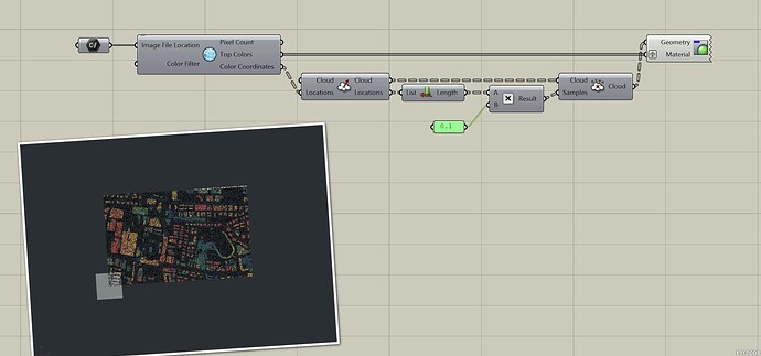

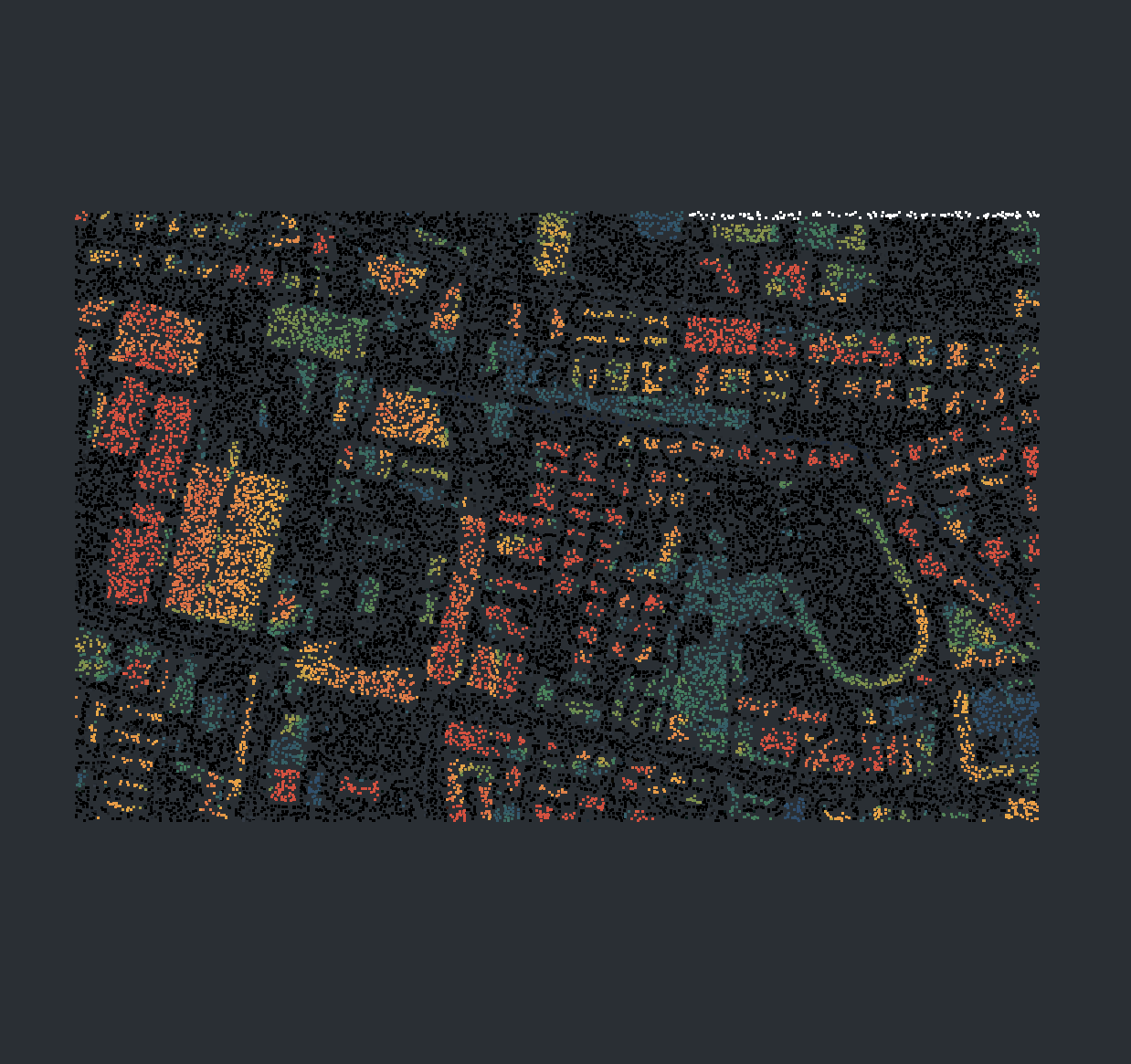

If my image is this (took a screenshot from open buildings)
Expected output is this - A pointcloud with values that I can extract using the color scale

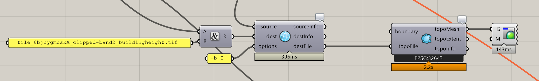

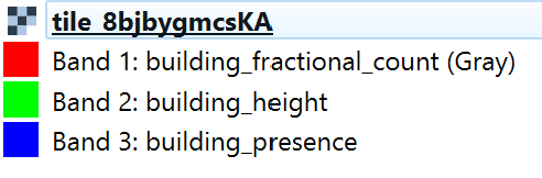

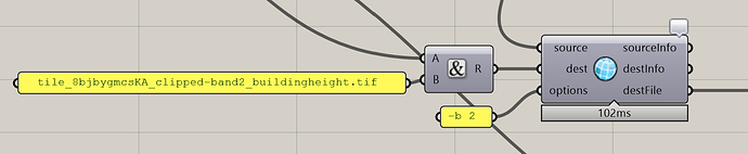

Inspecting this geotiff in Qgis, it appears to have 3 bands corresponding to “building_fractional_count”, “building_height”, and “building_presence” and is not an RGB gradient of color as seen in your screenshot examples.

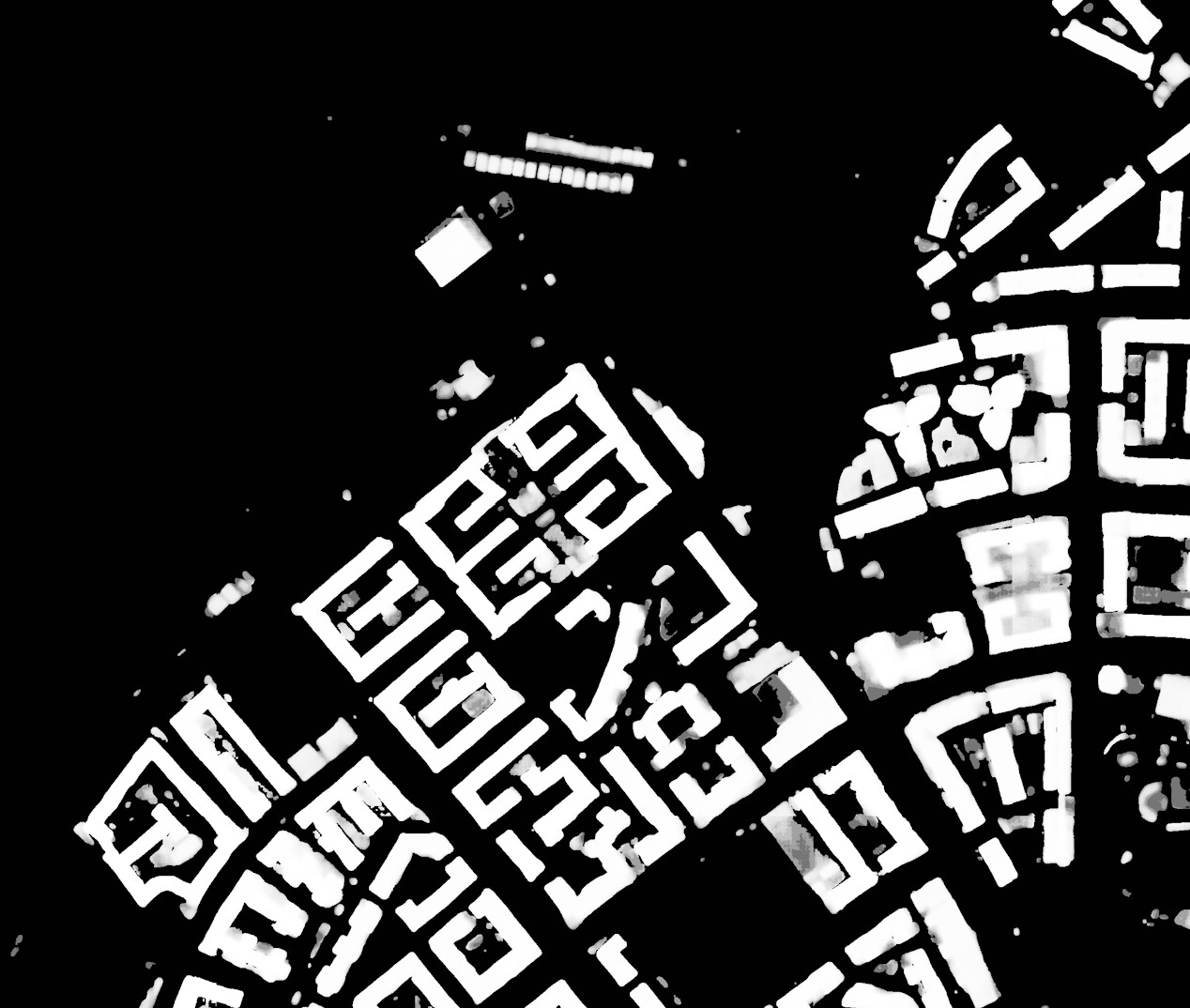

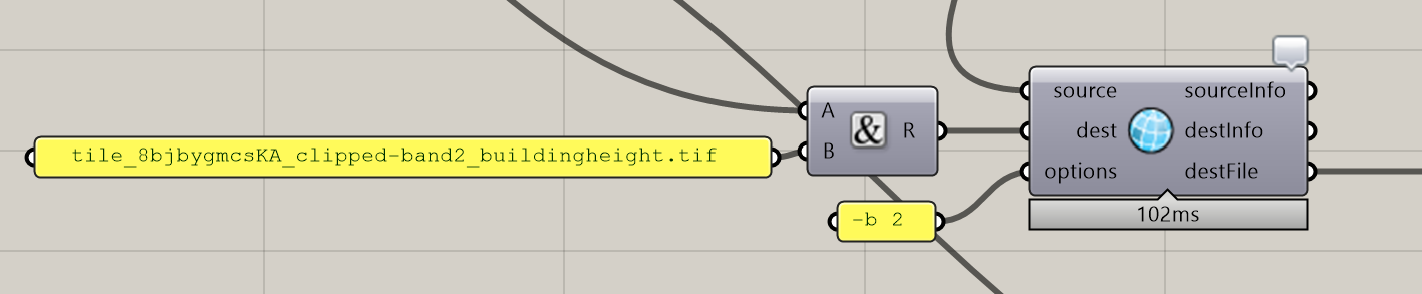

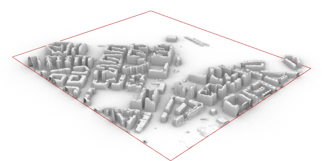

If you want to extract one of these bands, you can use GdalTranslate. The image below shows extracting Band 2 “building_height” as an example.

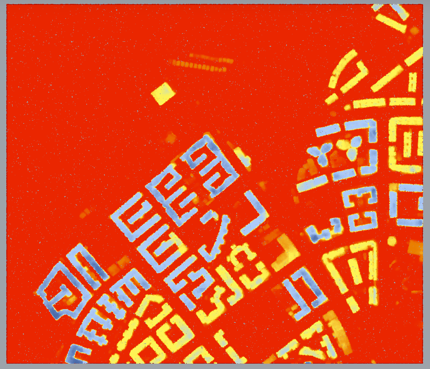

If you are actually looking for building heights, you can use the extracted band 2 to drive the ImportTopo component as shown here:
If you are looking for a color gradient as seen in your screenshots, this would require a couple more steps:

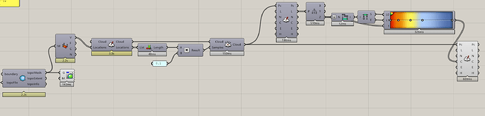

Here is the GH definition I’m using
raster image to pointcloud with color_BW.gh (32.6 KB)
Does this help?
-Brian

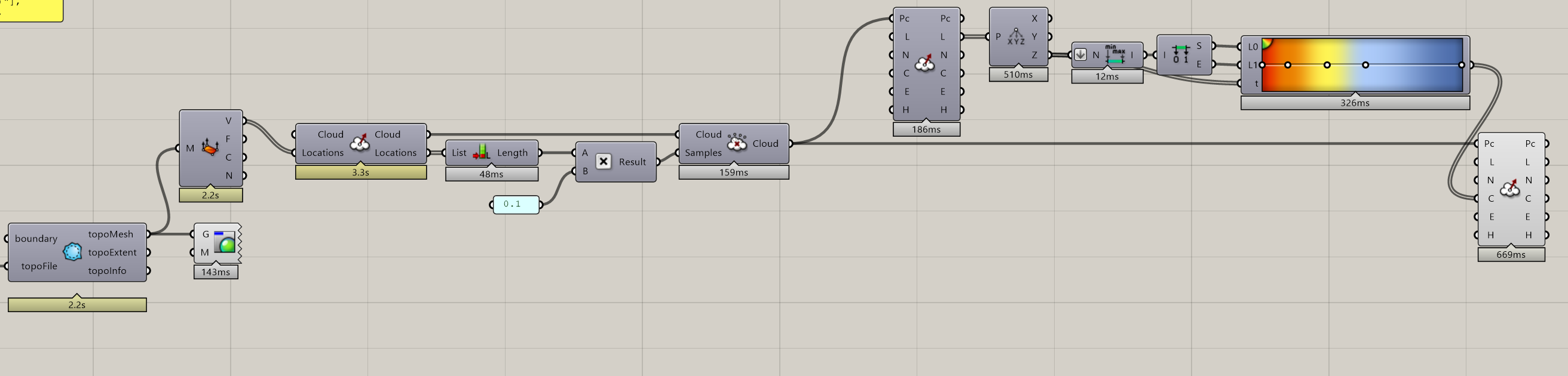

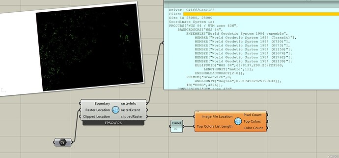

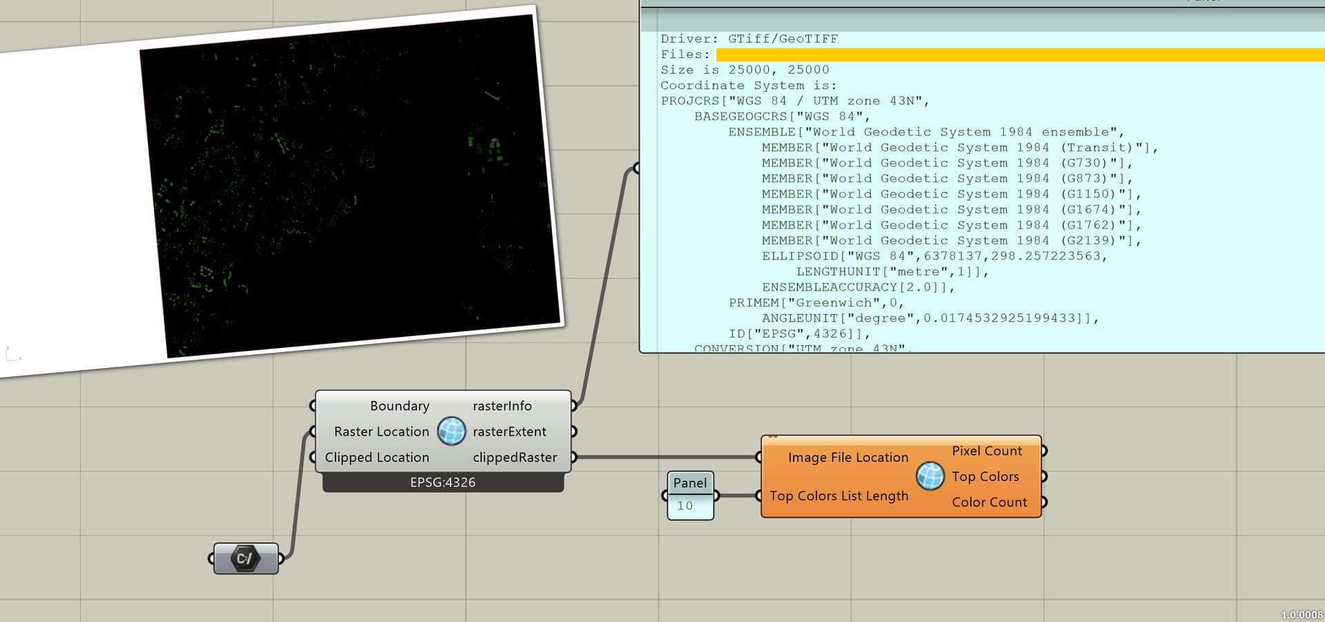

Hi @Brian_Washburn thank you I need exactly what you have showed me. However I am having some trouble setting up the definition here on my end.

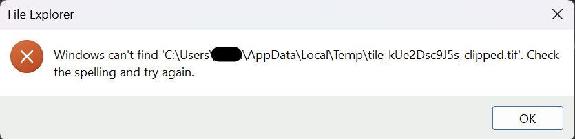

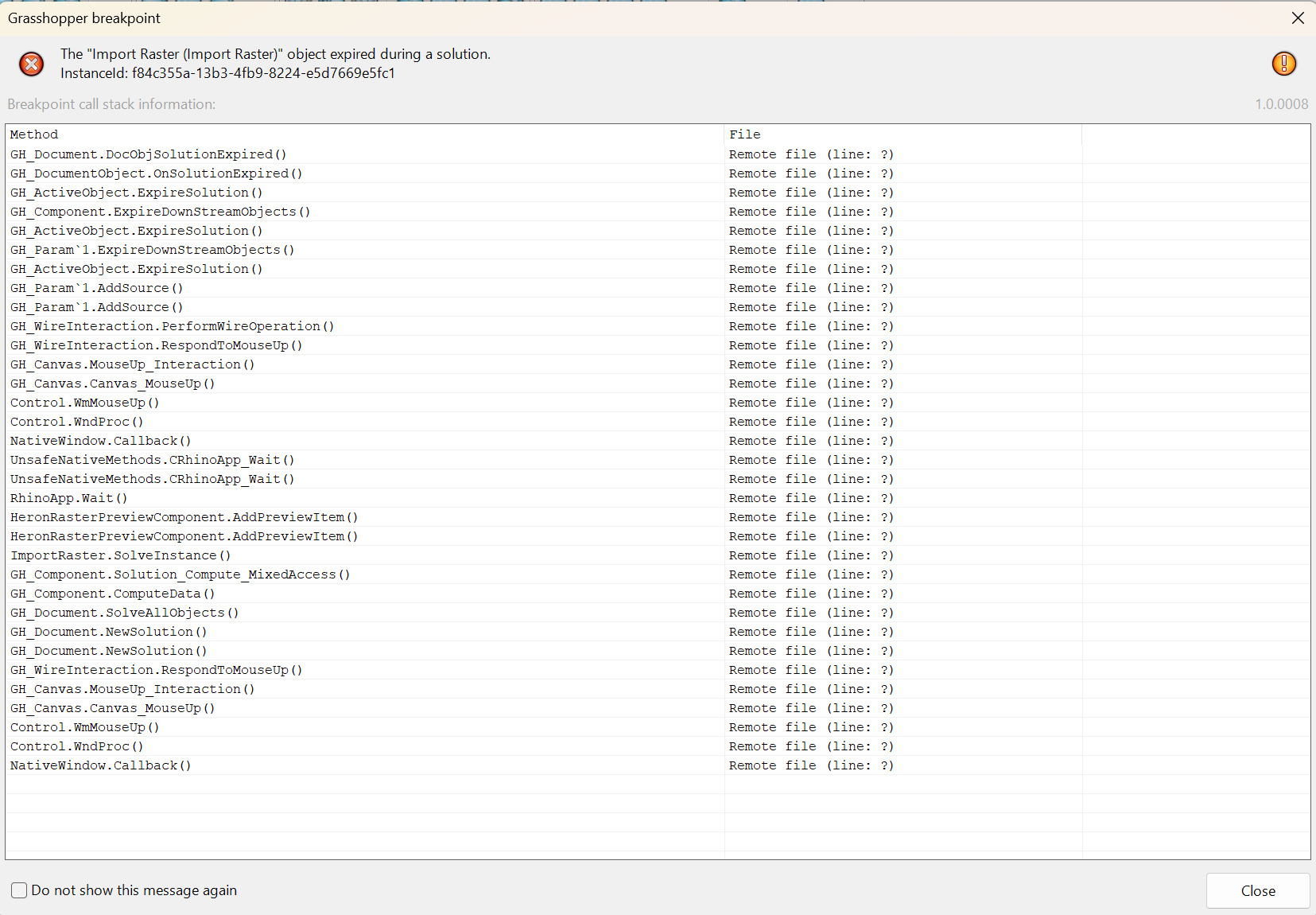

Every time I use the Import Raster component I realized that it is actually not saving the clippedRaster to the destination file. It is only saving the preview png file but not the clipped tif.
And I get this breakpoint when I attempt to attach a new wire to the Clipped Location file directory input
