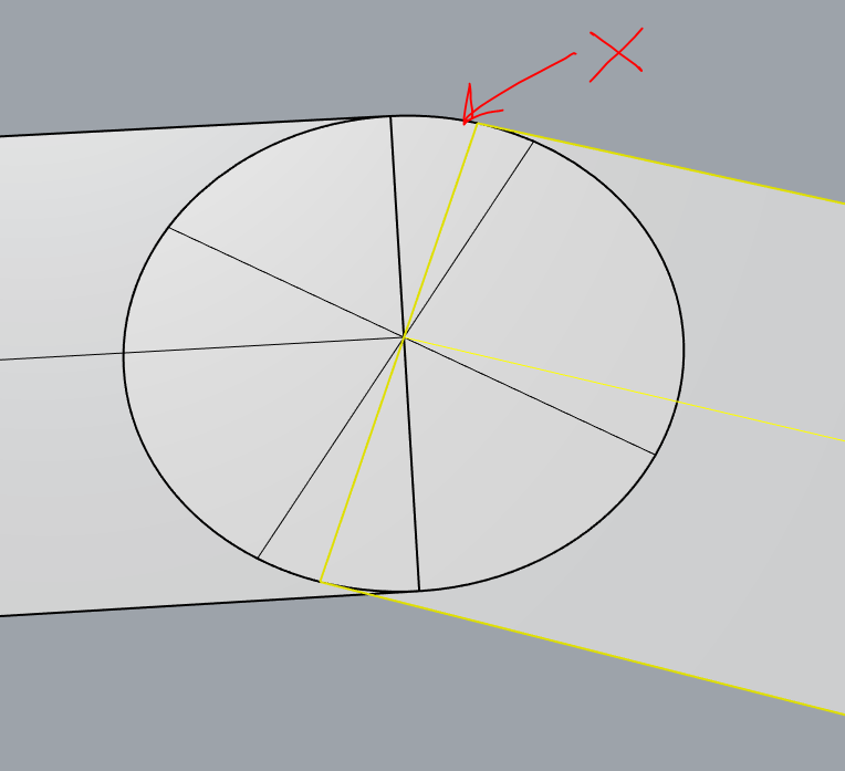

well
i narrowed it down to the problem areas,
with the intersection in orange
the black layer has the Srf that needs fixing.
maybe someone more knowledgeable would want to take it from here.
it’s very late in the night where i am.
some of these Srf do not fully intersect, other would join at double tolerance
If you simply remake these few Surfaces, i think you’d be ok.
NetworkWithIssues.3dm (3.8 MB)
