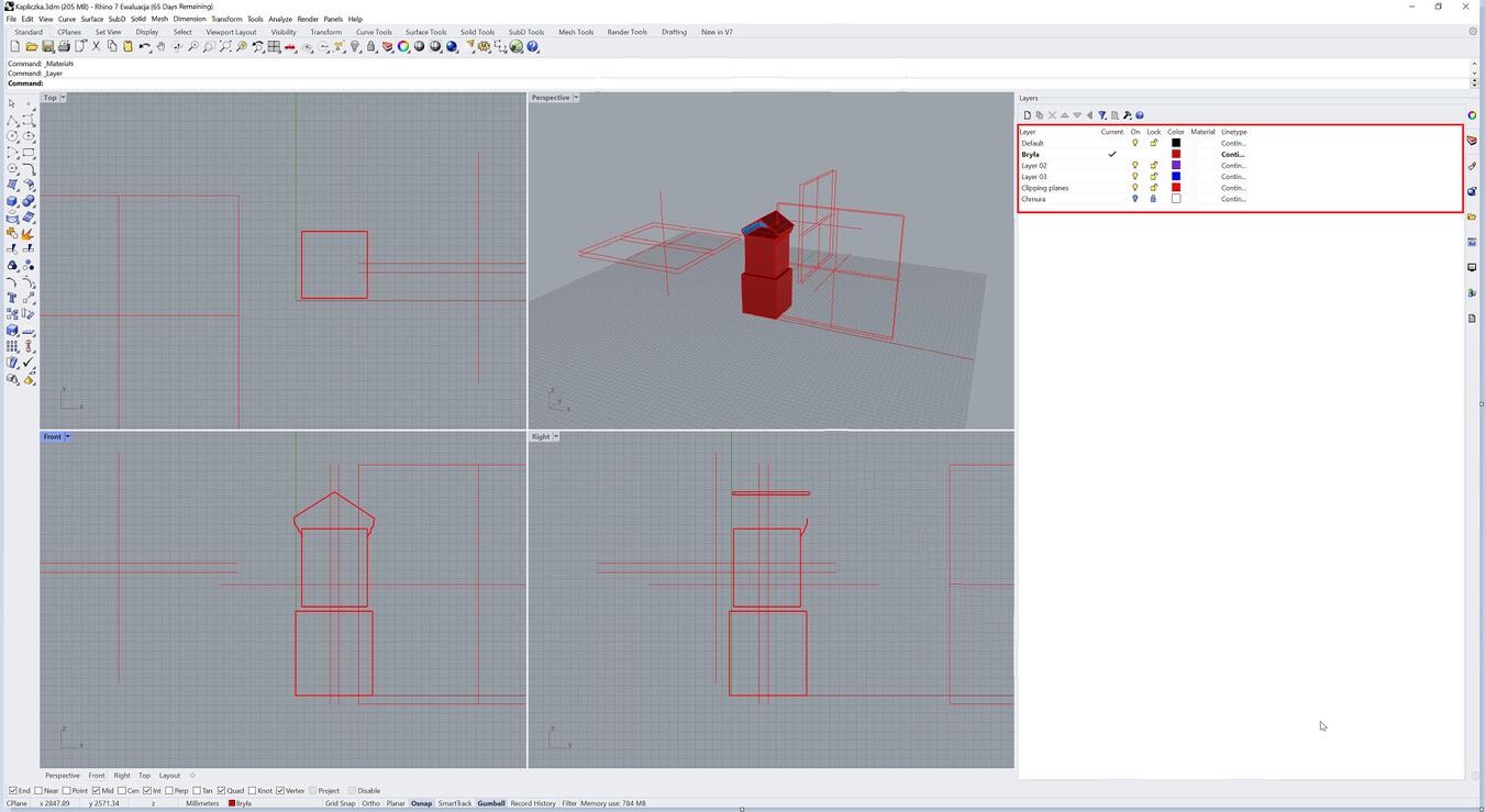

I would like to hide point cloud in one of the views but keep it in the others. I managed to do this for layer in one of the tutorials I finished. I remember that in the layer panel there were additional options which gave the desired effect. I will be grateful for help.
Hello - these options are available for hiding layers in a layout - you can specify detail view for which layers are hidden.
Thank you for your answer. It appears that these settings are available only for layout panel but not for normal modelling. I added layout with detail level 4 and now in layer panel I have additional options:
but when I go back to standard views they disappear:
Is it possible to somehow copy layout settings to other views?
