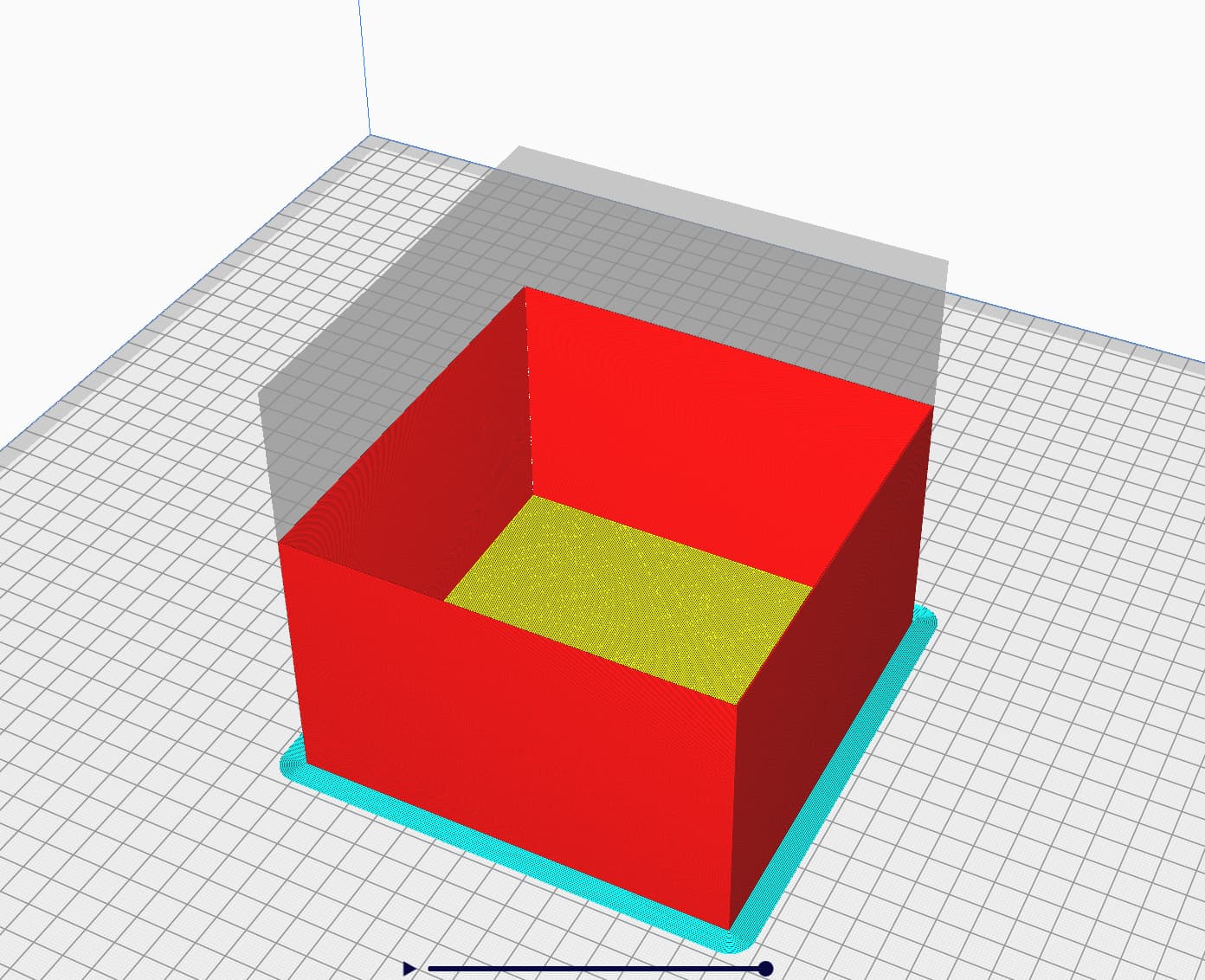

So, after this, I exported the geometry to STL and open it on ultimaker cura. After slicing it’s possible to see that the box is nothing more nothing less than a “void box” (see picture below):

Personally I don’t have an ultimaker, but a shot in the dark would be that your geometry is not closed when you export it, but 8 single face meshes. This would explain why you can load it into cura without complaining, but doesn’t fill.
Try and -_join your geometry before exporting as stl. else check your export options before exporting, where you can choose not to export open objects. this would give you an indicator if your geometry is closed or not.

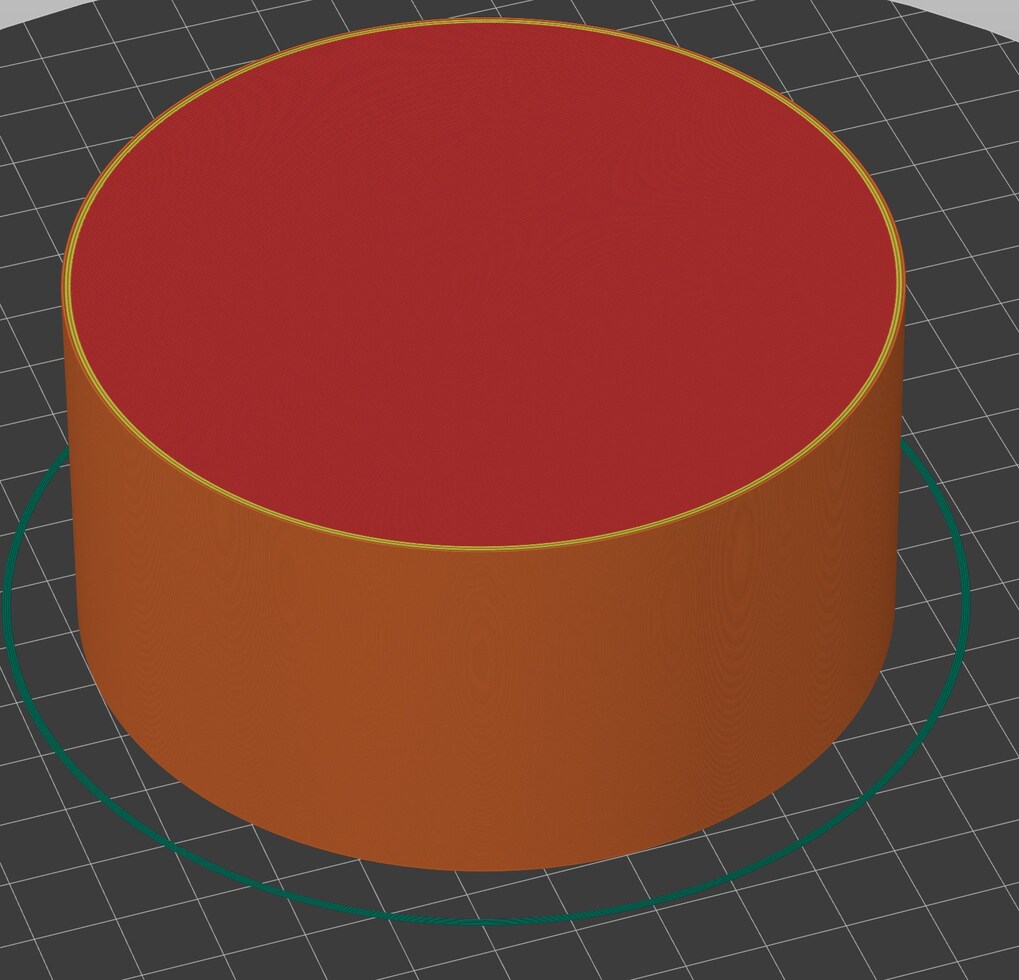

The way slicers work is to fill the inside of a solid object with what is called “Infill”. Infill is meant to “fill up” the empty space inside a solid object so it can have a top printed that won’t collapse due to no support underneath. Here’s a screenshot of my slicer showing what’s been printed at a height of 3.2 mm of a “solid” cylinder that is 50 mm in diameter and 50 mm high.
The dark red cross-hatch material is the infill; it is the so-called “grid” pattern set at 20% infill. That means only 20% of the open volume will be filled with printed material. Here’s what the finished print will look like:
The top surface will be 100% solid and the finished print will look like a solid cylinder, but the inside volume will be 80% empty space. This is done to minimize both print time and the amount of filament used to complete the print. Of course if a truly solid final print is needed you specify 100% infill.

Just to address your simple cube example which is unlikely, to say the least, to have naked edges or be non-manifest.
I created a 1cm cubed box in grasshopper, baked it to Rhino 7, saved to .STL format (ASCII option), then loaded that into Cura 4.10 and sliced. That created infill as expected - see for example at 75%:
I think you need to go back to your Cura software and check the setup - for example that the infill preview is turned on.

First of all, I want to thank you guys, for the suggestions. @benedict, @Birk_Binnard, @kev.r, so I followed your suggestions and it turns out that I had several open breps. I started modeling everything again more carefully and did accomplish a closed brep. After this, I exported to STL, and this time it worked and CURA opened it as a closed solid. Thanks again for the help!
@jeremy5 Yeah, I think I didn’t have that option turned on :man_facepalming:. Thanks!
