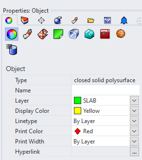

Now I have drawn a wall system and one slab polysurface. I have created a wall layer and a slab layer.
I want to change the slab to green color as the setting of of the slab layer but unsuccessful. What should I do?

Hi Ken -
Yes.
With simple shapes such as walls, you can sub-object select a single surface in a polysurface and move that.
With the slab selected, in the Properties panel, change the Display Color setting in the drop-down from “Yellow” to “By Layer”.
