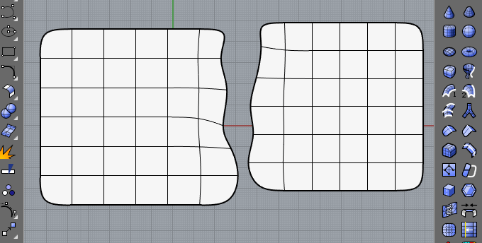

Thank @inju but this is not the case I’m looking for, these edges are far away, what I want to solve is the case when you have polygons that look joint in sharp mode, but need to be stitched.
I will share an example to clarify it.
I found the solution,
I didn’t know that this mesh command worked for subD too.
If there are small gaps first use _AlignVertices
And after all the vertex are in the place _WeldEdge to stitch them all at once.
This is quite handy in cases when you have multiple naked edges and don’t want to use the stitch command, a pair at a time.
