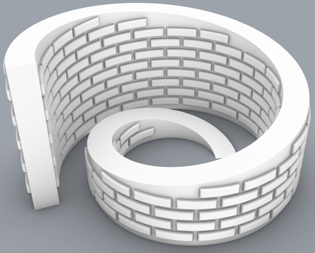

How about bricks? A few extend beyond the surface but I want to get coffee first. :sunglasses:
UPDATE: fixed brick alignment by flipping one branch of contour curves. (yellow group)
Base_2023Feb3b.gh (259.9 KB)

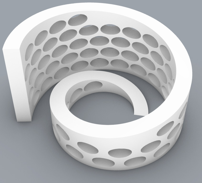

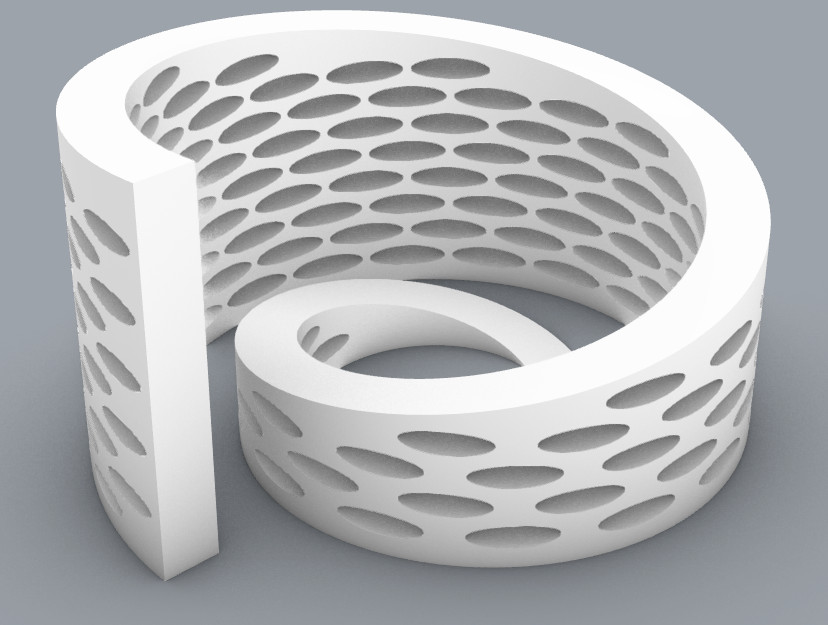

Staggered elliptical holes? SDiff takes 46 seconds in this case so is disabled in the file.
Base_2023Feb3c.gh (250.9 KB)
Might be better with fewer, larger holes? Faster too, only 12+ seconds for SDiff, I added a ‘Move down’ slider to shift all the points (holes) downward as there is extra space at the bottom.
Base_2023Feb3cc.gh (252.5 KB)

Your approach places the bricks directly, without morphing them. That gives a different final effect - the bricks look like real bricks with flat surfaces, not curved surfaces that morphing would produce. That’s a valuable difference and, for 3D printing, could be useful with a different base shape.
There is a 3D printing problem with your flat sided bricks - the protruding bottom surfaces can’t be printed because there is nothing holding them up. A 3D print is constructed from multiple horizontal layers - each layer is a series of 0.4 mm diameter loops of extruded plastic. Each new layer has to be extruded on the top of the previous layer - otherwise it droops and looks funny. That’s why the “bricks” on my version have sloping sides; the slope is carefully made so that there is enough contact from layer N to fully support layer N+1.

Yup - I tried that approach too. It has the same problem, only in reverse: the top surfaces of the indentations are unsupported.
So I guess holes are forbidden also? 3D printing appears to be severely limited.

Actually holes are OK if they are carefully designed:
In these cases the holes are ellipse with the long axis vertical - to minimise the size of the unsupported area. In the first case all edges filleted, but not in the second. If you look at the 2nd image in the PerfVase1 link you’ll see ugliness around some of the holes. That’s when I realized that filleting the edges of all the holes would help. For Meshcontainer1 I guessed at the fillet radius and should have made it a bit larger.
The morphing distorts the ellipse quite a bit, and you don’t see the cleanup I did to neaten up the tops of some of the holes. Also, for the top one I reduced the thickness of the solid sides, so there aren’t many loops that are subject to malformation.
Filleting is a good approach for allowing holes, and I’ve done that several times. The key to success is positioning the tops of the filleted hole makers so that the tops of the printed holes require few and short lengths of extruded filament.
Merely parameters, as is the choice between fillet and chamfer.
