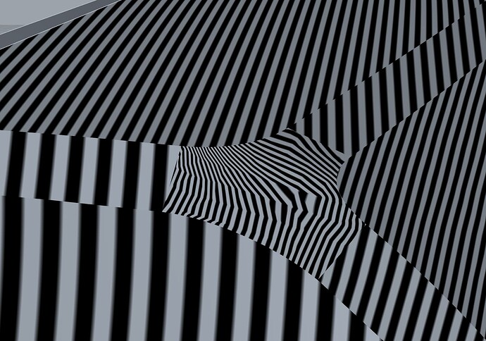

Hey there, i would like to make a smooth transition as shown in the pictures. However it seems that i lack some knowledge / tricks to make this work. I am familiar with BlendCrv, NetworkSrf and the difference between Position, Tangency and Curvature. I just don’t know how to solve a 3-side polygon hole…

another attempt, but not working:
Patch works, but the transition isn’t really nice.
Well, It’s a cheap way out but Patch does OK here - you need to duplicate the curved edges as curves for the input and use the straight surface edges directly.
@andreas6 - here is my go at it with just a patch
3part_transition_Patch.3dm (139.5 KB)
yeah, thats the cheap trick, i mentioned it already. But to fulfill my needs for proper renderings there has to be no visible “edge” at the transition.

I nearly got where i want.
  1. filled the whole hole with a patch
  2. create a triangle as shown.
  3. Split patch with triangle (red)
  4. create 3x. NwetworkSrf with curvature (blue)
if there is a better / cleaner solution i would welcome it.
A different approach which needs some control point location refinement:

IMO you are working too hard using a triangle- The singularity will fight you till the end.
I’d go for more something like this.

With two surfaces something like this:
You can also make this with single span surfaces if you cleanup the surrounding curves / surface edges.
@Rhino_Bulgaria has also made a video of this approach:
You can also try this approach in case that you are aiming for a nearly Class-A surface quality with clean surfaces. But keep in mind that it’s slow. The quick “dirty” approach is already shown in the port above.
