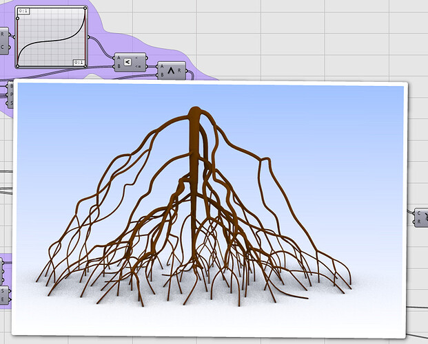

Funnily, I used the Shortest Walk Tapered Branching Script to create the branching shown above since the L-systems weren’t working. The smoother geometry thread is exactly what I was looking for, so thank you
Hi there,
This looks amazing, my reasoning for going with the method I initially did is because the roots don’t have much variation in angles/root numbers. Within the Range of Degrees slider, if reduced would that factor in a simpler form such as below?

Here some explanation on a way to have something more similar than that you want.
let say you want something in a cylinder of radius 10 and height 10, centered on 0, 0, 0
Let’s generate the roots with seed points on a disk. The points are set on 2 levels Z=0 and Z=-1.
Then points on the trunk
Then points to join roots and trunk. Points are generated using Populate 3d,
then some test to suppress points outside the cylinder. Then a Graph Mapper to change the density on Z.
All the points are merged. Then Proximity 3D and then ShortestWalk
Then some algorithm of mine allowing the smoothing of lines network. I think of others methods … quite better.
I also reuse the algorithm to calculate the radius of branch.
Then Dendro, not perfect as the radius calculation is not done with the smoothed curves.
Strange creatures (1000 points on bottom)
20201210_mangrove_tree_LD.gh (36.8 KB)

Thank you for the explanation, I can see where I went wrong not having generated and connected the radial points with the separate trunk (and the shortest walk that connects through both). The smoothness of Dendro really is amazing despite it not being from smoothed curves. My initial piping process, came out far too clunky even when I did rebuild the curves.
Would it be rude of me to ask for the definition and play around with it further?
Warmest regards
Don’t worry the definition is provided, see above! It is always more pleasant to work for polite people that makes effort.

It is because I let one of my library. Indeed code was in script so
you can suppress “usingLDutils;”
And suppress what is before SmoothNetorkOfLines()
And right click on component
And “Manag Assemblies’”
and suppress
LDutils.dll
Plan B: Sandra promotes potato vodka (yikes!). If things are really tough … give it a spin (only for the brave).
And I forgot to mention that you can play with the number of point in Point Proximity 3D
it also possible to use the Length in Shortest Walk to have different directions …
Many many way to have better results.
