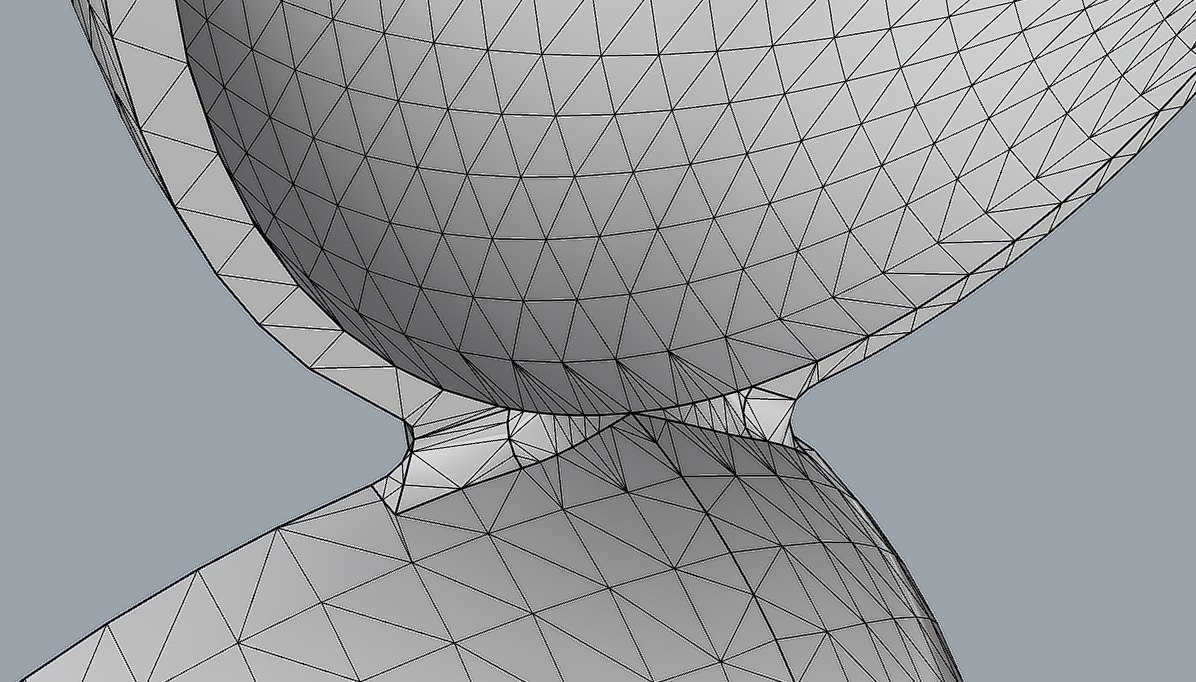

Hi, I’m new here, I’m trying to model the famous lamp Dalù by Vico Magistretti, and I would like to know how to connect this two hollow spheres.
This is where I’m right now. I was only able to overlap the two spheres.

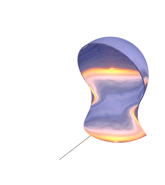

This should be the final result.
Or also something like this. Any ideas?
here is my attemptsphere to forum.3dm (778.0 KB) —Mark
I used a plug in called xnurbs to help in what I did.

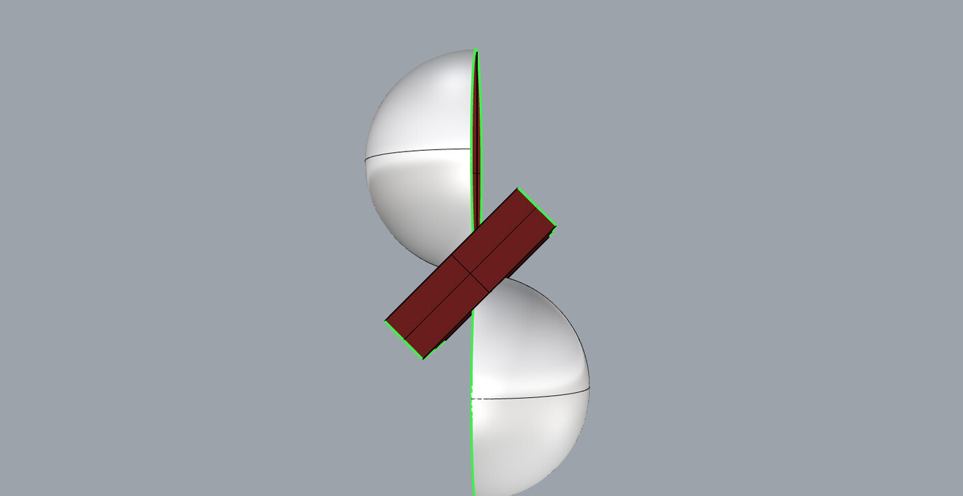

I would make a Sweep2 between the spheres like this:
using few BlendCrv on the ends and the middle as cross sections
Diego, would you have thickened both sides to get the desired thickness?
Much simpler than my attempt.-Mark
hi, yes I used OffsetSrf once joined the 3 surfaces

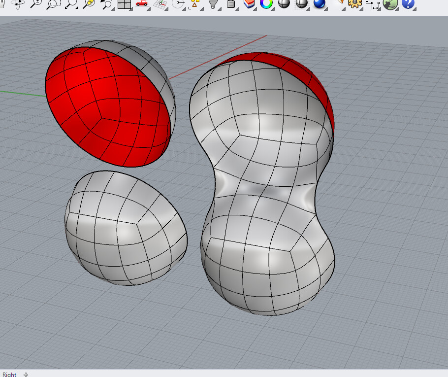

You can also use subd
Command: _Bridge
Command: OffsetSubD
Thank you all! You were very helpful!
