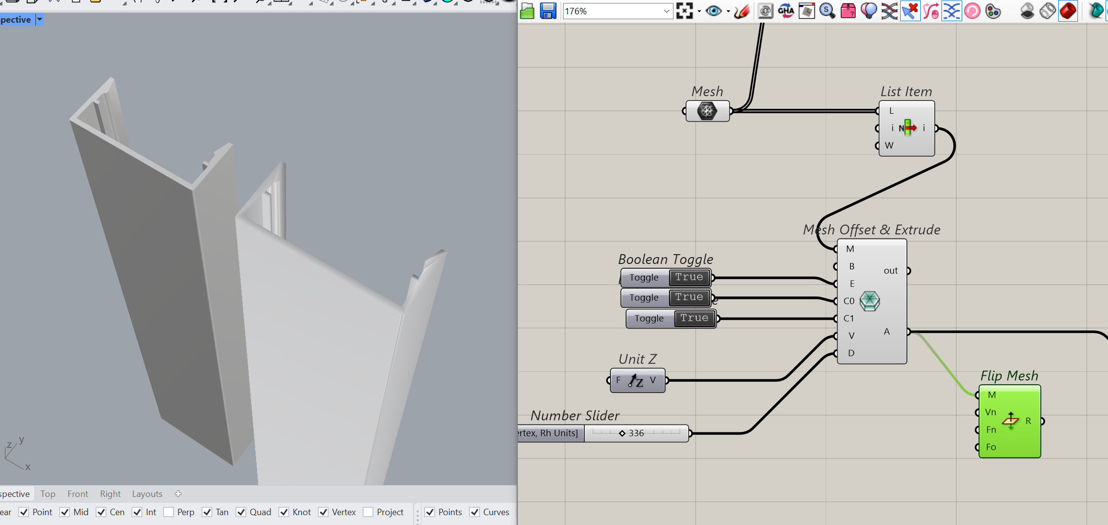

on the left in gumball extrude of flat mesh, on the right it is baked mesh from grasshopper using mesh +, how can i bake it flat, may be there is node that can make mesh be flat shaded? thanks!)
oon the left in gumball extrude of flat mesh, on the right it is baked mesh from grasshopper using mesh +, how can i bake it flat, may be there is node that can make mesh be flat shaded? thanks!)
oUnweld Mesh is what you’re looking for…
Left box is extruded with the gumball. The one on the right thickened in Grasshopper with Weaverbird.
Weaverbird’s Mesh Thicken / wbThicken
