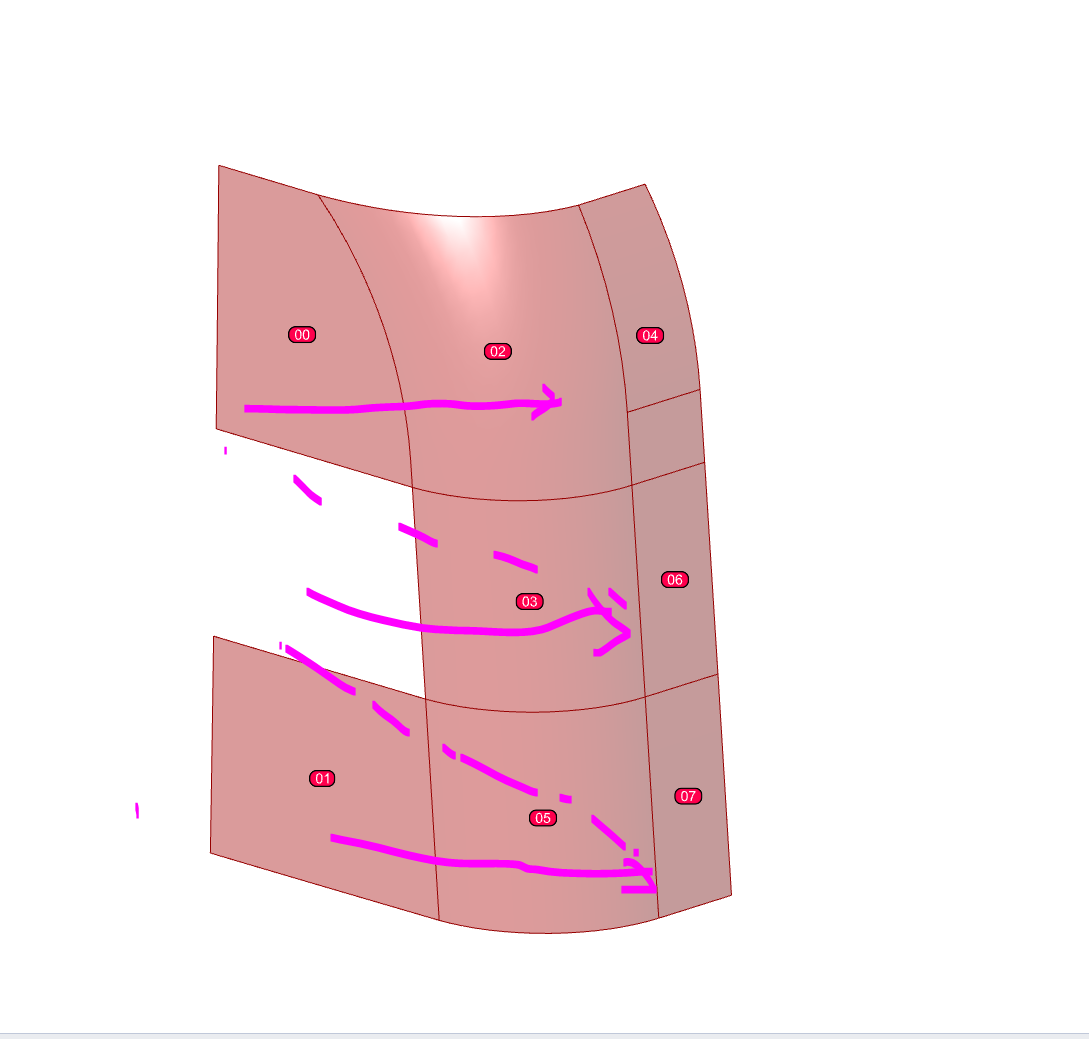

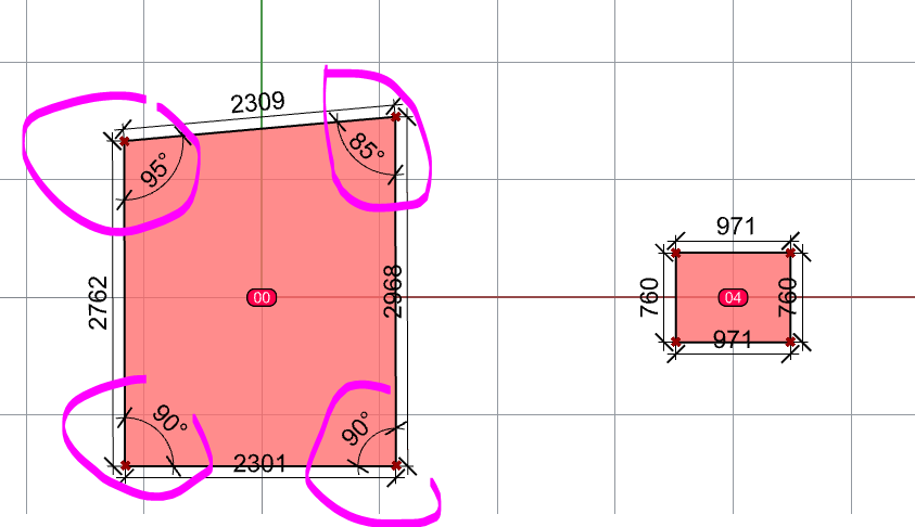

I am trying to add angle dimensions to all unrolled panels for documentation purposes. I’ve tried several methods, but none have worked as expected, as shown in the sketch below.
Additionally, regarding the paneling sequence, is there a method to sequence the panels starting from the point closest to (0,0,0) and moving upward?
