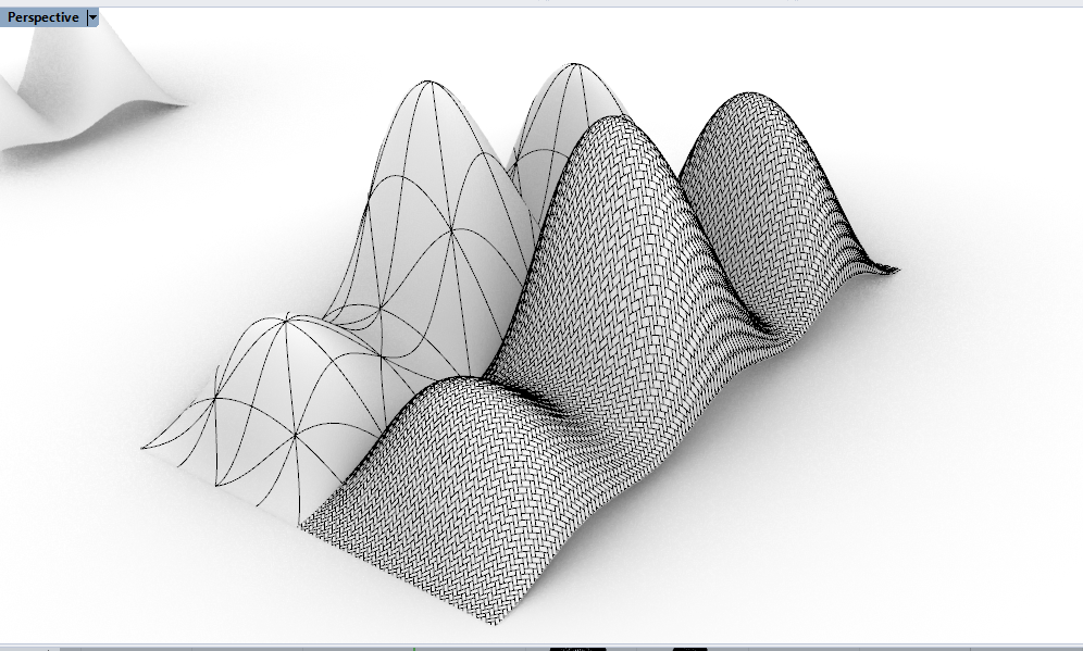

Problem is, how do I import, trace and even add the beautiful “Darker” lines on the outside of these figures while inside remains lighter in line weight?
I will show you guys the example:
Also, at the same time, How are these “Hatches / Patterns” created? I tried using Photoshop but I am not able to get the Hatches / Patterns flow so naturally and accurately with the contours… Hope someone can guide me please… Thank you!
For tracing a bitmap: trace plugin
The second part: I think it’s projected linework on a surface. Underneath the surface the original linework is visible. If you find the right hatch pattern, I think you should explode the hatch and project the exploded linework onto the surface.
edit: trace.3dm (2.1 MB)
it works quite well. it’s a low res bitmap, so a higher resolution could give a better result.
edit #2: the result for the second partlines on surface.3dm (5.1 MB)
edit #3: The darker line you can get with make 2D: it’s the silhouettelines on surface v2.3dm (10.0 MB)

I use Inkscape a lot for artwork (https://inkscape.org/). It’s the Open Source equivalent to Adobe Illustrator. It allows you to trace a bitmap and convert it to vectors. You can then import the SVG into Rhino.
Sadly the trace plugin is V6 only.
Also note that this plug-in is based on Potrace, which is available as a Windows command-line utility here:
http://potrace.sourceforge.net/
