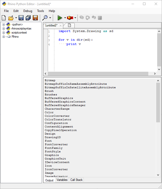

Depending on what exactly you’re implemented PIL for, you might consider switching it out for a .NET library instead (i.e. that will work with IronPython). The standard System.Drawing namespace might meet your requirements:
@AndersDeleuran - Thanks very much for the suggestion. I managed to do what I wanted within 10mins using the System.Drawing.Bitmap class. Much less of a personal challenge than reading the bitmap bytewise myself, but it has given me my weekend back so thanks for that!
