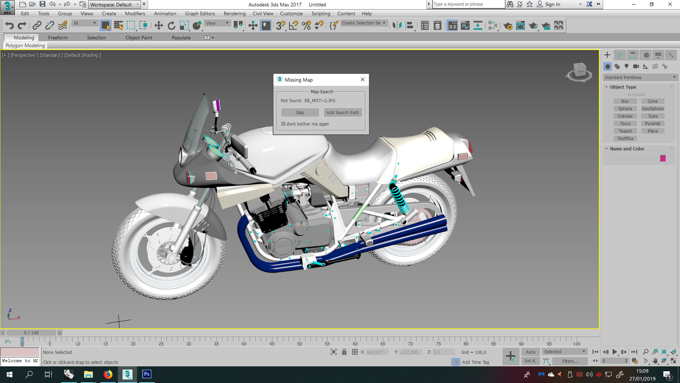

Let’s say I have multiple meshes objects with different materials associated. Different materials sharing one (or more than one) texture.
when I export it as OBJ, Rhino creates duplicates of the same texture for each material, instead of recognizing it’s the same texture (same path) and ‘linking’ it to more materials. It has no sense because it increases the overall project size for no reason.
If I simply delete all duplicates, 3DSMax will prompt for the missing textures
