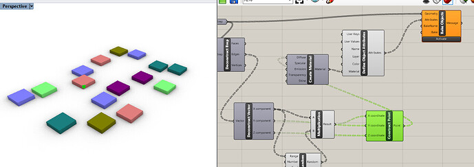

Looks like you found a solution already, if by any means you need another, I just stated learning the Elefront Grasshopper plugin trying to use as a layout tool, but it has a material attribute as well, maybe you can try it and see if it works for you.
I Kinda got it working, but the material generation needs improvement to not generate duplicates
