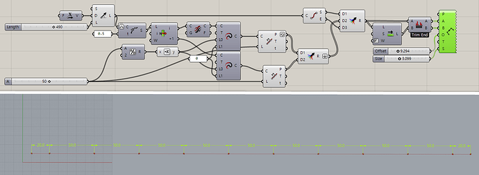

One of many ways maybe?
Canvas at 21;56;13
1383×508 113 KB
Divide Curve_re.gh
(11.7 KB)

Thank you. perfect.
