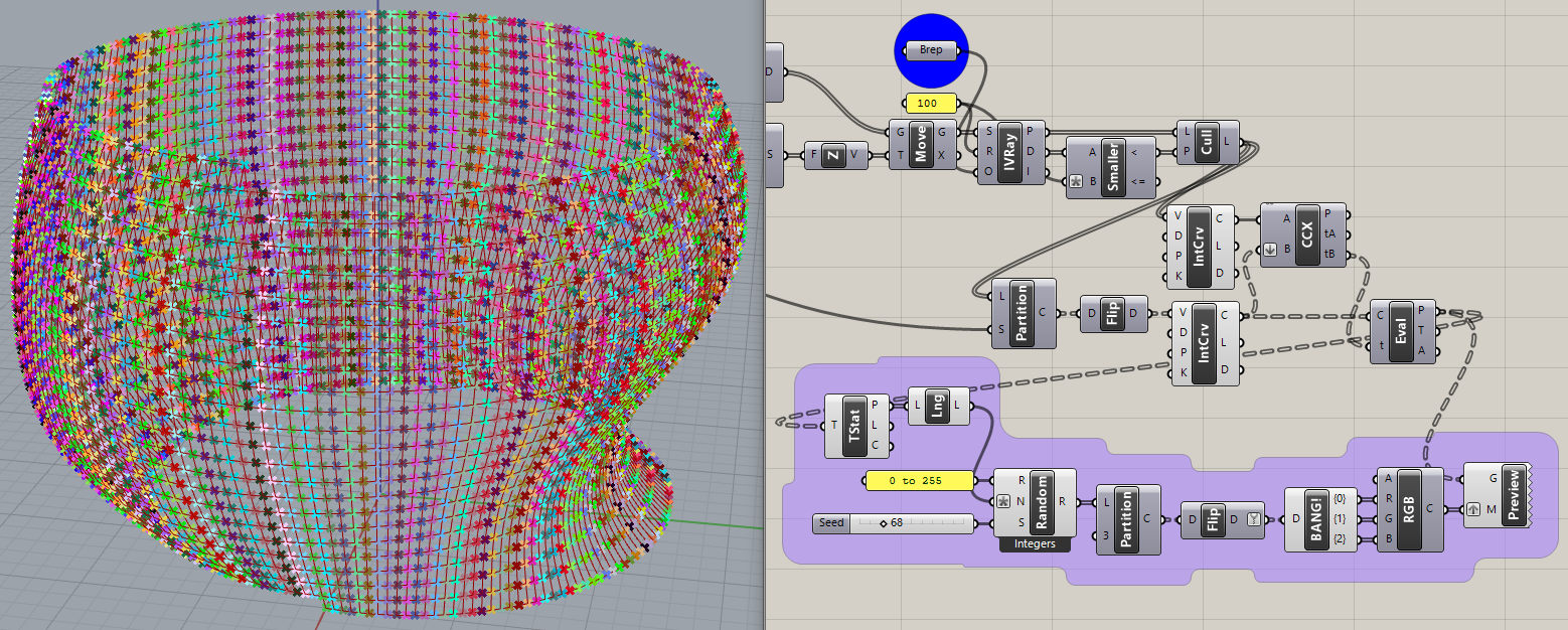

I have tried and failed for ~5 years to solve this problem with bricks.
One area can look fine but it falls apart somewhere else when all rows are not the same length.

here is my attempt:
Oh? Please do tell? Your “bricks” vary widely in length, which isn’t feasible with real bricks, though the gaps between them can vary to some extent. Even so, I see places in this image where vertical lines are aligned across rows, which is what you want to avoid.

I am not sure if this is is ment to be sarcastic. It’s true that they are vary a lot, since this isn’t about actual bricklaying but about 3d printing pattern on a surface where spacing it is not so critical. This thread started out with the question about how to connect the layerlines without disrupting the pattern.
Maybe this is difficult, maybe one has to do the helix first. My only concern is by doing the helix first the same problem will shift to “how to distribute points on a helix so they are equidistant and form nice enough grid” which is equally difficult.

A brick laying thread/model based on contours, not a spiral, and using an “Impala” plugin (wait, that model seems to work without Impala?). Interesting but as I noted above, some vertical lines on adjacent layers are too close together.
I’m looking in this direction: (though not sure I really want to pursue this)
one problem occurs when the shape varies and the vertical lines run to close together:
my definition keeps some distance at the cost of a few vertical overlapping lines:

As probably many others already said, with non-constant circumference it’s impossible to avoid any alignment. Somewhere it has to have some imperfection.
Used zombie kangaroo to smooth isocurves and build a elix (maybe this step could have solved better)
Used zombie kangaroo on a Z scaled helix to make sphere collision to spread and de-align teeths.
Build teeth out of polyline and lastly piped to a mesh.
This method is surely wrong for big builds.
Probably an iterative method should be used, like: building the helix tooth by tooth and “foreseeing” the alignment with teeth on old layer, solving the problem as it reach and going on.

Yes, I think the trick is to hide the imperfection over a large area or to make everything a bit random so the mind just assumes perfection ;-). Similarly architects will draw jiggly lines to make them appear more straight then they are.
Thanks to your definition you posted earlier, I got an idea how to add a helix to my dot distributor ( the one posted here: "perfect" grid in 3 dimensions - #9 by Konrad). and the results are looking promising but to early to call it:
I believe this is correct, as a human brick layer would do, achieving “perfection” instead of hiding flaws.
Something like this…
vase_zigzag_V3.gh (52.6 KB)
It “looks” for lower layer and divide the remaining space into even spaces, always keeping the pitch larger than the give value.
It’s tweakable. imperfections are still there, nothing can be done to remove them… we know already.
